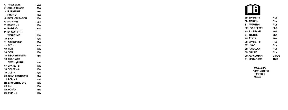

I replaced the third brake light and the light still does not come on. Where is the fuse box located for the third brake light?
Nov 29, 2018 at 3:31 AM
HARRY P
  • 2,292 POSTS

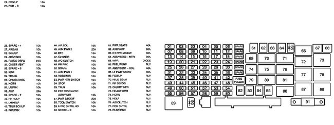

Hello and thanks for using 2CarPros. I am attaching some images detailing where the fuse box is that contains the fuse for the brake lights, and a layout of the box (split into two images). You would be looking at fuse #54. However, this is most likely not your problem. If it was, then none of your brake lights would be working.

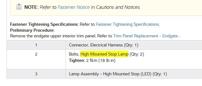

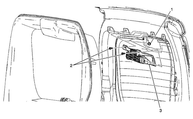

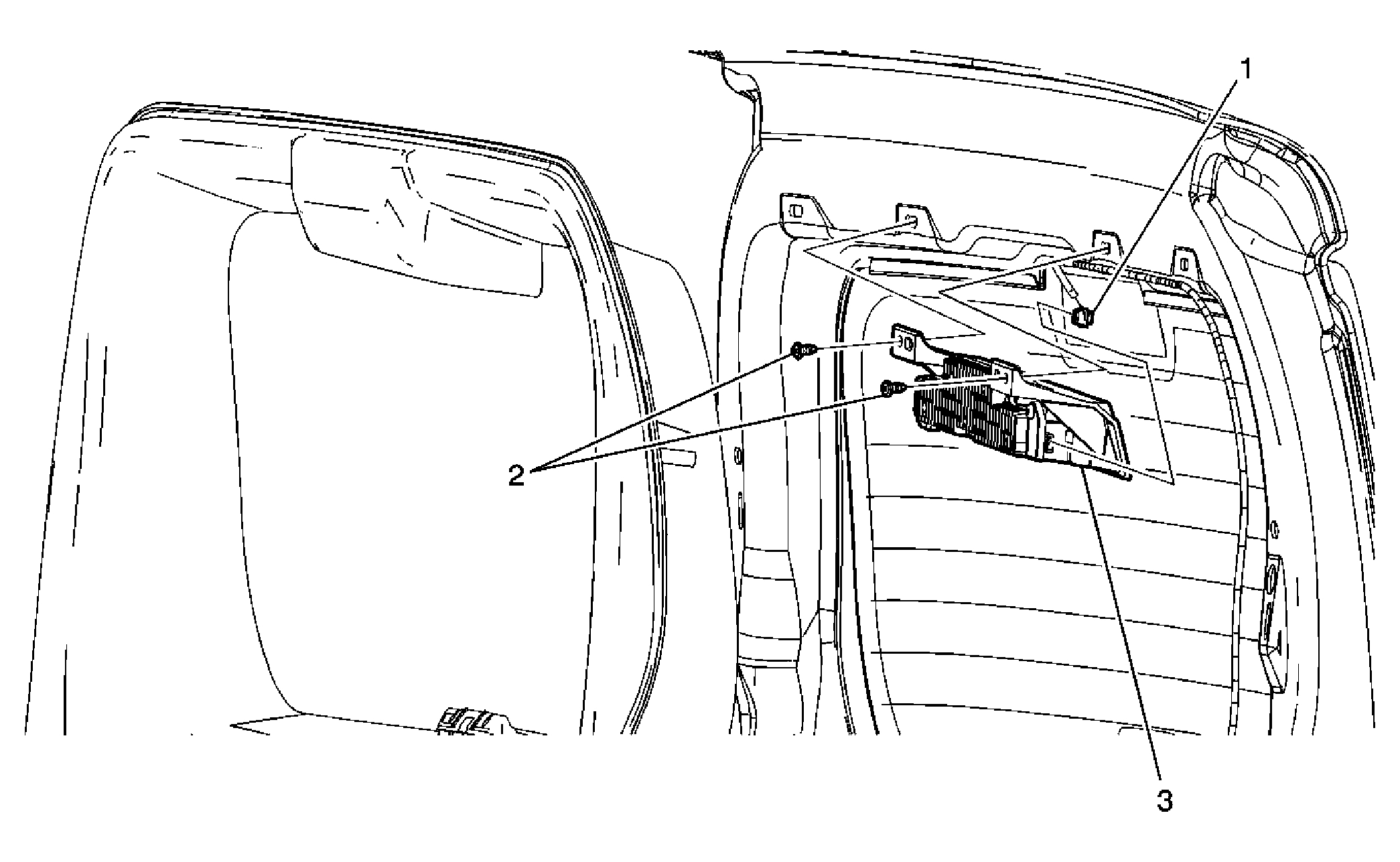

Our resources do not offer much in the way of telling you how to remove/replace the socket, but I am including what we do have in the fourth and fifth images below. Please check as much as you can, and get back to us and we will go from there. Thanks and good luck!
