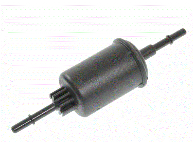

Where is fuel filter?

This vehicle isn't offered in the US, so, my info is somewhat limited. However, I'll do my best to help.
The filter is located under the vehicle at the front of the fuel tank. It will be tucked up along the side of the tank I attached a pic of the filter for this vehicle below so you can see what you are looking for. You will need to safely lift and secure the rear of the vehicle to access the filter.
As far as replacement, here is a link that explains in general how one is replaced. You can use this as a guide.
https://www.2carpros.com/articles/how-to-change-a-fuel-filter
Let me know if this helps or if there is something I can do to help you.
