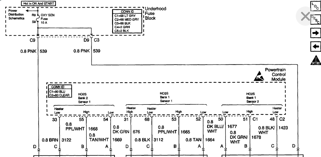

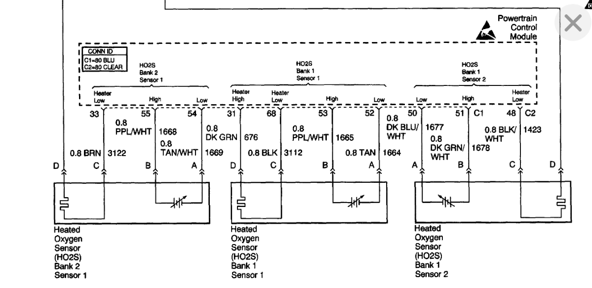

I bought a car and the wires are cut from the old o2 sensor, so now I can't find the rest of the wires that have the male connect to the female. Basically the male and female are still connect just cut from the o2.

Which O2 sensor are you talking about?Usually you can find the bigger wiring harness and just follow it down in the direction of the O2 sensor. You should run into the cut wires. I have included a diagram of the O2 sensors in the diagrams down below. Please go through it and get back to us with what you find out, please.
Thanks,
Alex
