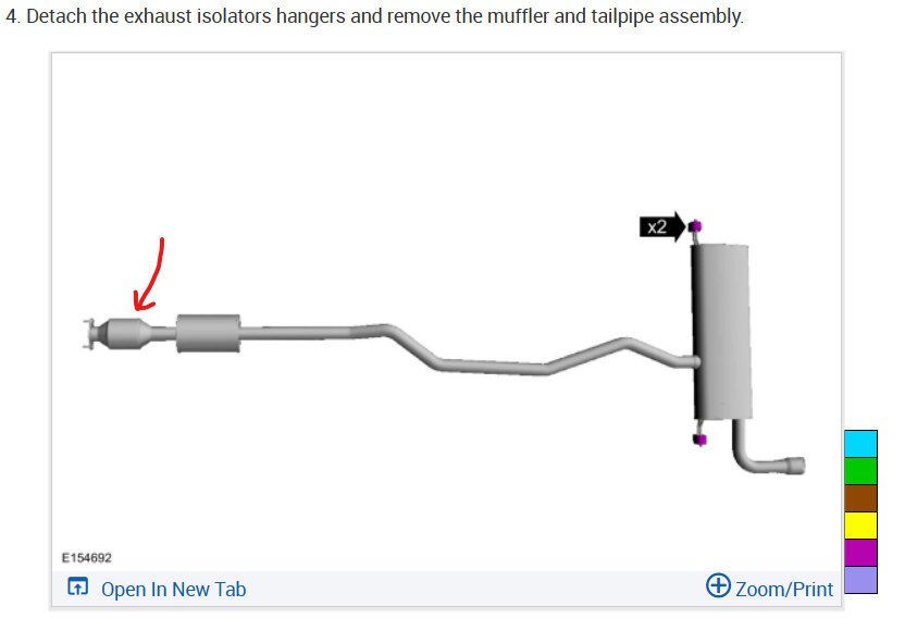

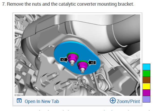

Where are the catalytic converters located and how many are there on this car?
2013 FORD FUSION
400,000 MILES • 2.0L • 4 CYL • TURBO • 2WD • AUTOMATIC
DAYCAT
Black smoke coming from the exhaust.
Dec 18, 2024 at 4:08 PM
  • 55,443 POSTS
This can have two catalytic converters; the first one is near the exhaust manifold right after the turbo and the other is down on the exhaust system slightly. Here are what they look like.
Check out the images (below). Let us know if you need anything else.
