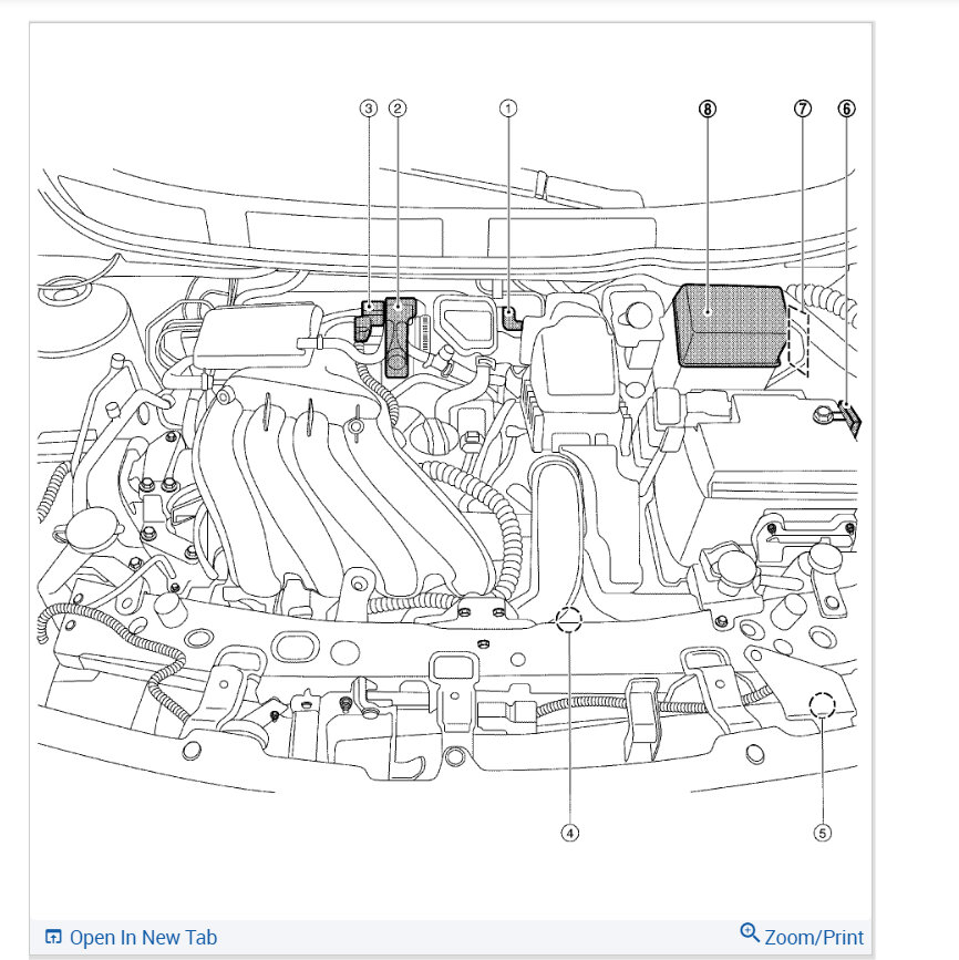

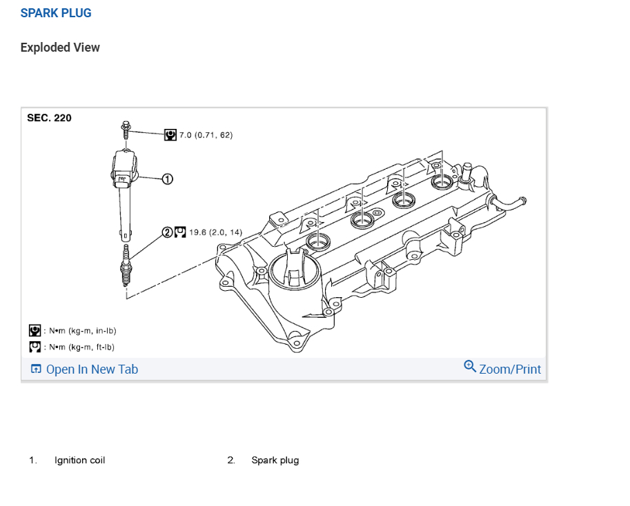

My vehicle listed above SV, when will it need a tune up or spark plug replacement? How much does that tune up cost at tire kingdom? since they need to remove intake manifold and related components to access direct ignition coils spark plug boots and spark plugs.
Dec 14, 2022 at 5:19 AM
  • 55,224 POSTS

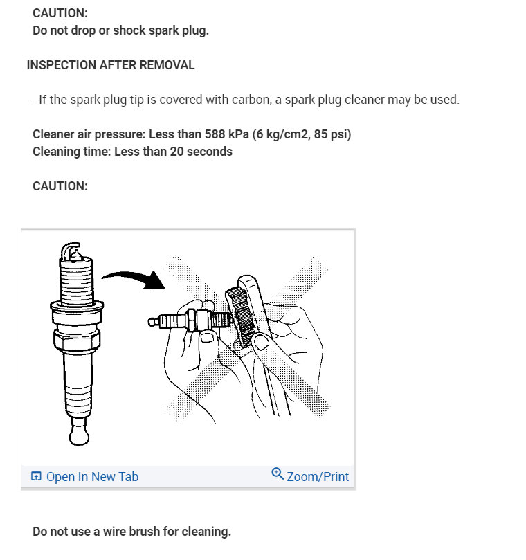

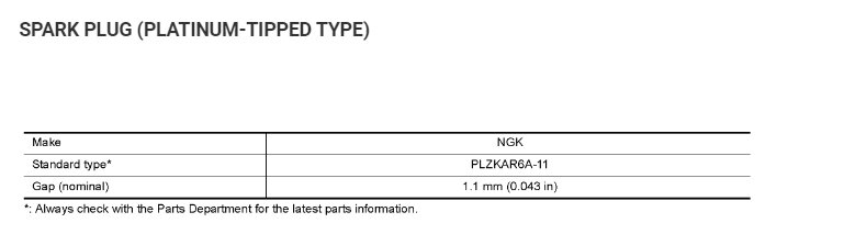

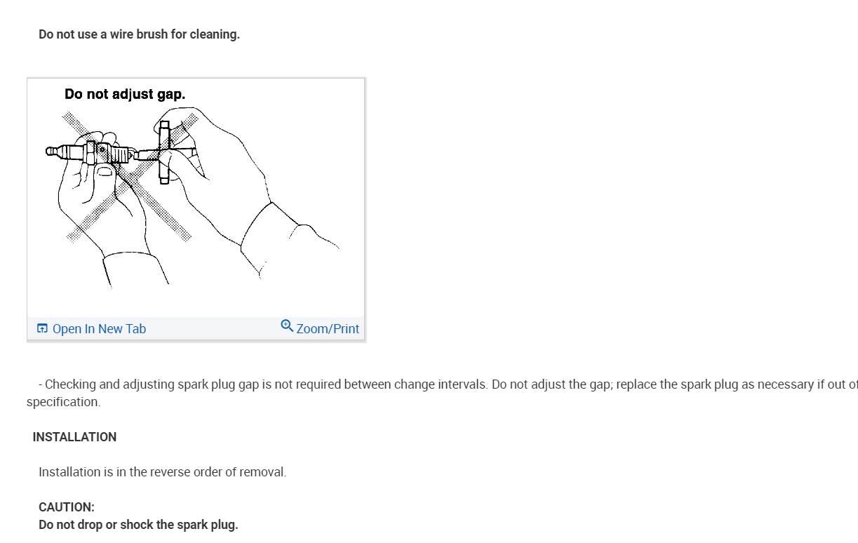

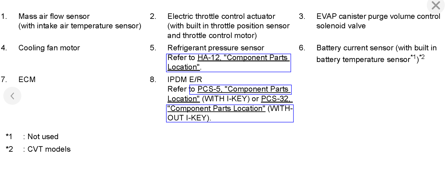

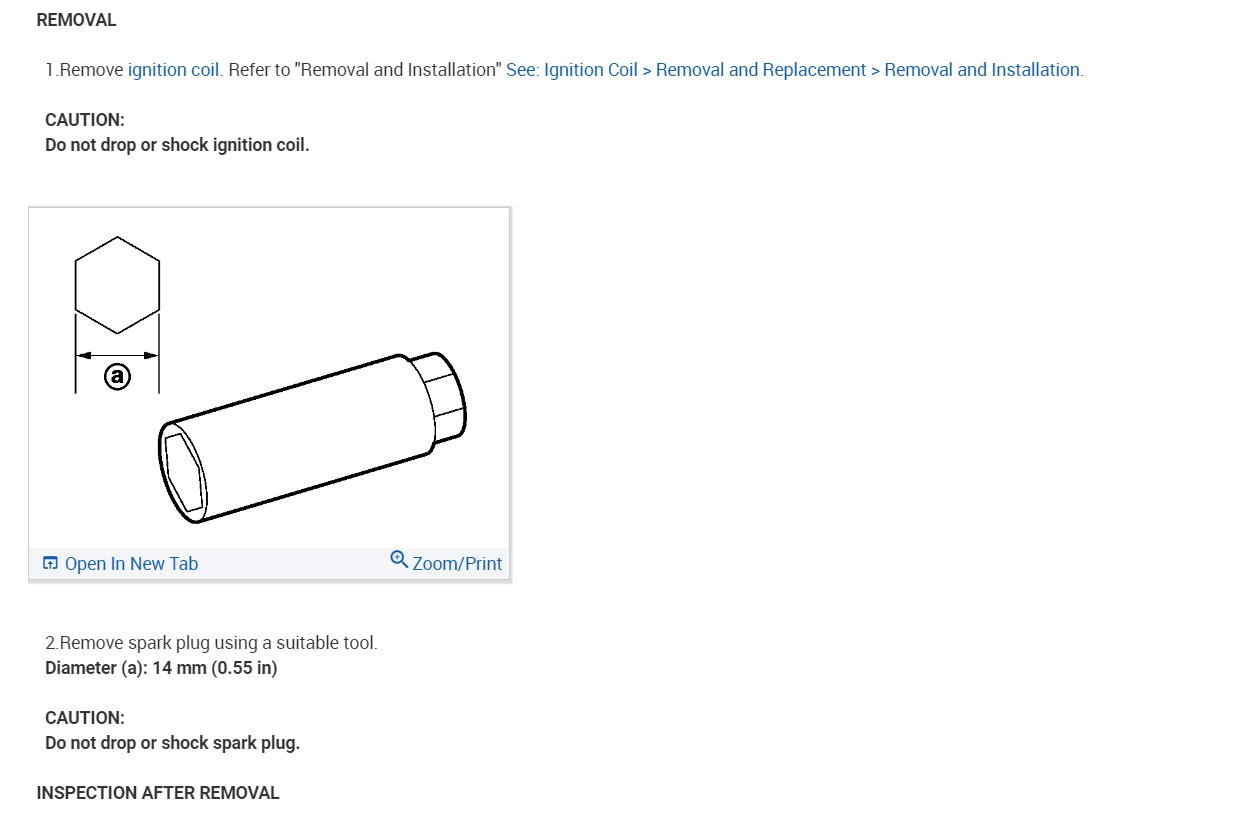

Yep, at 85,000 it is time for a tune up. here is how the job is done and how much it will cost. You should service the throttle body as well. Here are two generic guides to help walk you through the procedure and show you how the job is done with images below to show you how to do it in your car.
https://www.2carpros.com/articles/how-to-tune-up-a-car-engine
and
Spark Plugs, R&R 1.6 HRS @ shop labor rate. For the spark plugs the throttle bore service will be extra. Also have them check the air filter as well. Check out the images (below). Please let us know if you need anything else to get the problem fixed.
