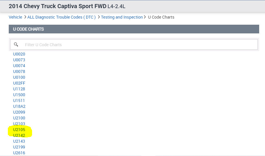

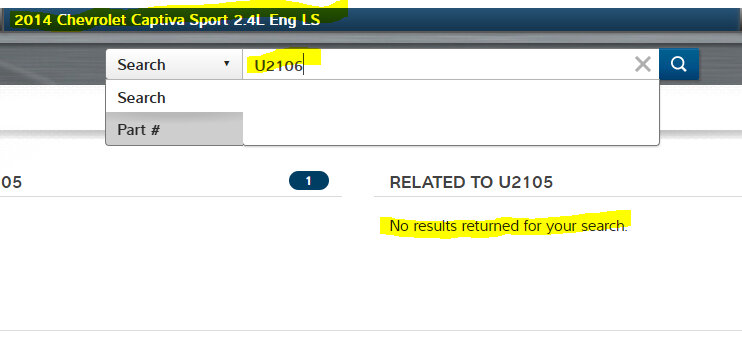

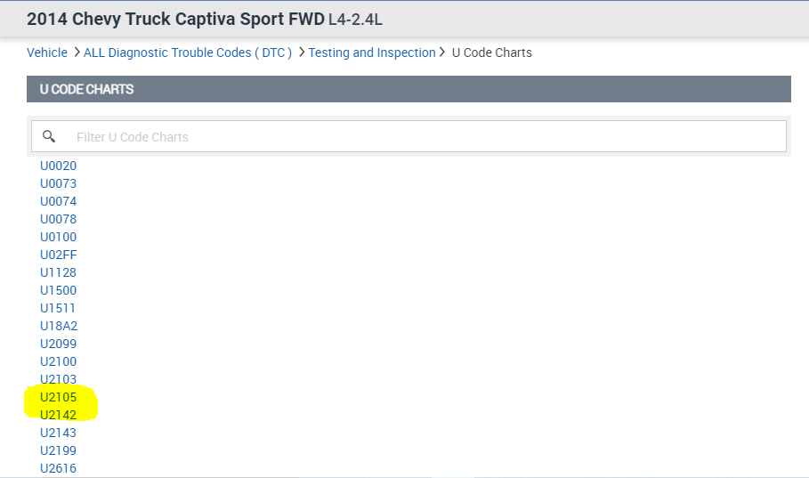

Here is the issue I'm having on my end. I tried to look up information based on the code you provided and according to two manuals, it isn't related to this module year. See pics below.
If you look on the driver's side door or door frame, you should see a couple of labels. See if you can find one with the production date. We have a very early or late production date that pushes diagnostics into a different year.
