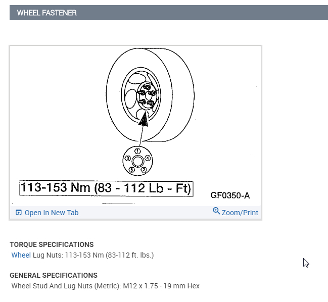

So today I have run into an issue I had a month ago and that involved my rear tire rolling down the street. The first time it happened was simply because of the fact the wrong size lug nuts were put on so they stripped out. Got the studs replaced and today noticed one of the studs snapped so on the way home the wheel came off and all the studs snapped off. I have a set of Fuel Hostage 20x9 time on the truck with a set of 33x12.5R20 tires. Do I need bigger studs to support the weight of the wheel or am I over/under torquing the lug nuts down ? These are a set of universal rims also.

This should not require larger studs. I suspect this is one of two issues. First if the studs are actually breaking off then I suspect you are over torquing the lug nuts which is stretching and compromising the stud. The other possible cause is under torquing which allows the wheel to move slightly and it actually vibrates the lugs loose and the wheel eventually falls off. However, before this happens it normally makes some noise.
Here are the torque specs for tightening the lugs. I would replace the lugs again and then inspect all the others to make sure they are not stripped and then torque them to the proper spec.
Let me know if this make sense. Thanks

Ford's torque specs for your wheels have a rather broad range of 83 to 112 foot pounds. I wouldn't go much higher than 100 - 105 foot pounds with cast wheels. 110 foot pounds should be good for steel wheels.

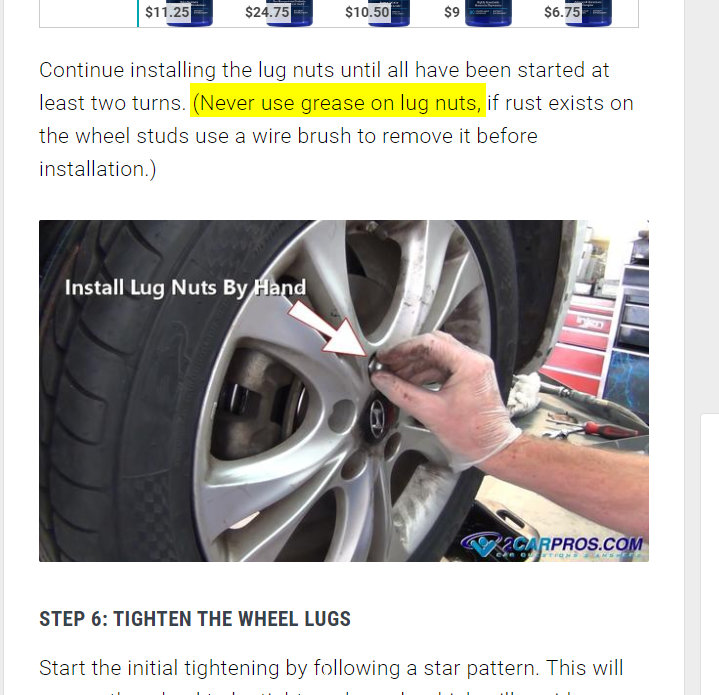

Related to that is the use of grease on the studs. First, most import vehicles use "anodized" studs. Those have a light yellow, light green, light blue, or silver color. That anodized coating is a lubricant in itself and no grease of any kind is supposed to be used on them. Some greases will melt that coating resulting in the threads peeling when you try to remove the nuts, even when they were tightened properly the last time. When you do use grease on non-anodized studs, use just a very light coating to prevent rust. Many people think if some is good, more must be better, but that is not the case. The problem develops when you use an air impact wrench to run the nuts on, even though you stop short, then finish the job with the torque wrench. That wad of grease builds up ahead of the nut, then centrifugal force flings it out onto the wheel. There it gets caught on the friction surface and prevents the nut from holding on. If you do use a little grease, run the nuts on by hand, then torque them.

Just to jump back in. You don't want to put anything on the studs like oil, grease, anti seize. The lugs can rust but you just simply brush it off with a wiring brush. If they are bad enough then you replace them. Take a look at the guide that Cariodoc provided (screen shot below).
When you add this to the stud, it actually changes the torque force because it lubricates the threads and allows it to turn more as the friction on the stud to lug is less and you can over torque them again and compromise the stud.

So I replaced the studs torqued them all down to 100ft/lb as Ford states. One question. Considering my rim and tire set or significantly larger than stock would I be better off converting to a M14x2.0 wheel stud or will the stock M12x1.75 do fine ?

The studs are a product of the vehicle's weight, not the wheel size. That's why some trucks have six or eight studs even though their wheels don't weight much more than those with five studs.
The exception to this is if you have aftermarket cast wheels that are significantly thicker around the holes than the originals were. That would reduce the number of threads the nuts would cover. In that case you's need longer studs, not fatter ones. That would have been specified by the wheel manufacturer or the person who sold them to you.
