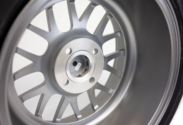

Hey, I keep having wheel studs snapping on my car. I have changed already four times in the last three months. I also used a torque wrench, and they snap when I was torquing them. But I mainly hear them snap when driving. Does anybody know why they keep snapping?

Usually wheel studs will only break off while driving if you have a loose wheel on your car. The loose wheel might be due to over-torquing or under-torquing the lug nuts when the wheel was installed.
Are you using original or aftermarket rims on your vehicle?
Non original rims may have a problem with the center spigot (center part of rim) not being of the correct diameter to fit the wheel hub correctly, see image 1 below

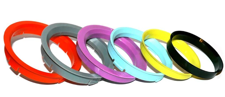

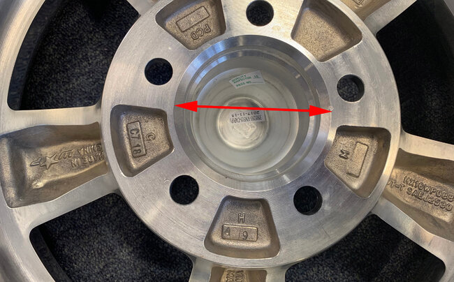

This usually can be rectified by fitting spigot rings of the correct diameter, see image 2+3+4

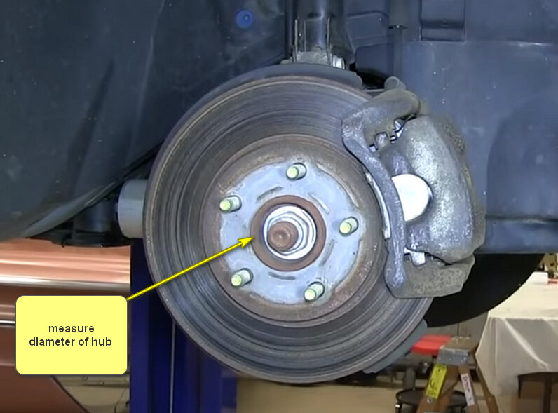

Do the wheel studs only snap off on one wheel?
If so, I would next check the diameter of the wheel hub center and compare with other side.
See image below
Check that the dimensions are the same.
