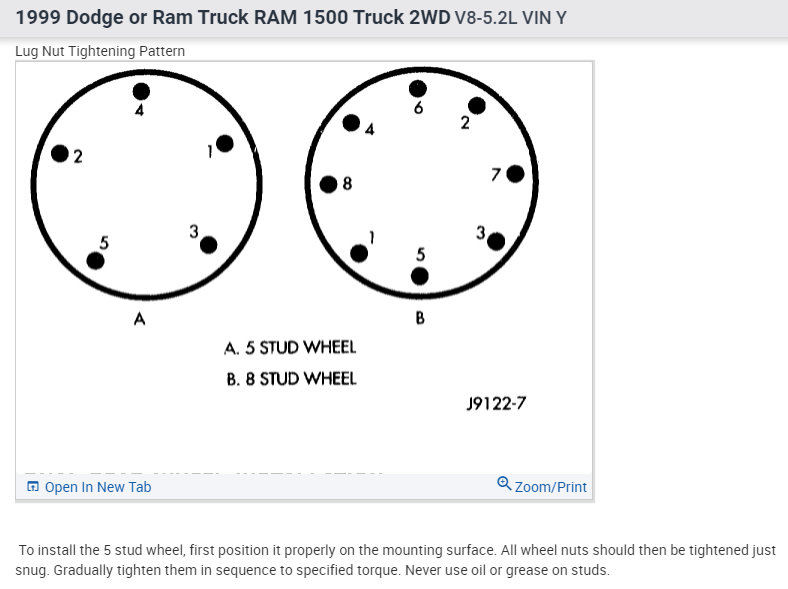

Can't get left front wheel off.
Dec 11, 2021 at 6:04 AM
SQM
  • 6,383 POSTS

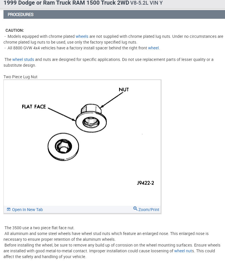

Can you tell me what exactly the issue you are running into?
Are you having difficulty taking of the lug nuts?
Or the issue is the wheel is stuck on the hub?
https://www.2carpros.com/articles/wheel-removal-and-re-installation
If the lug nuts are off and the wheel is still stuck, it is simply seized on the hub. You will have to use a mallet or hammer to tap and release the wheel.
