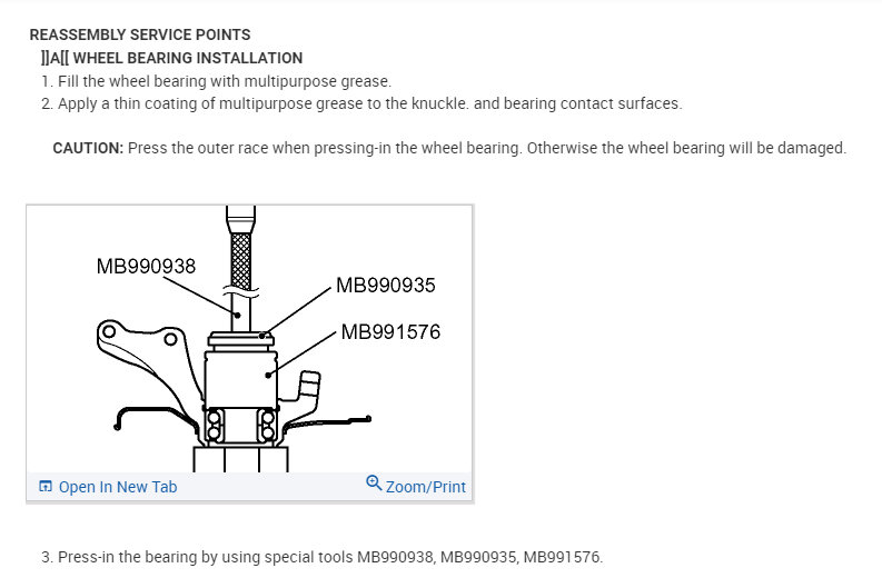

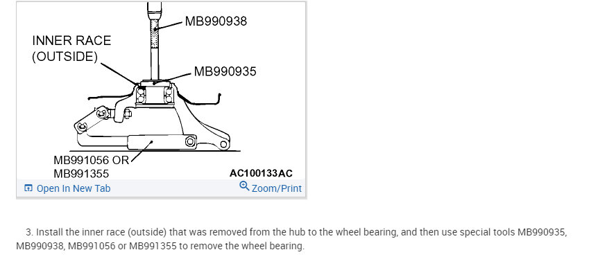

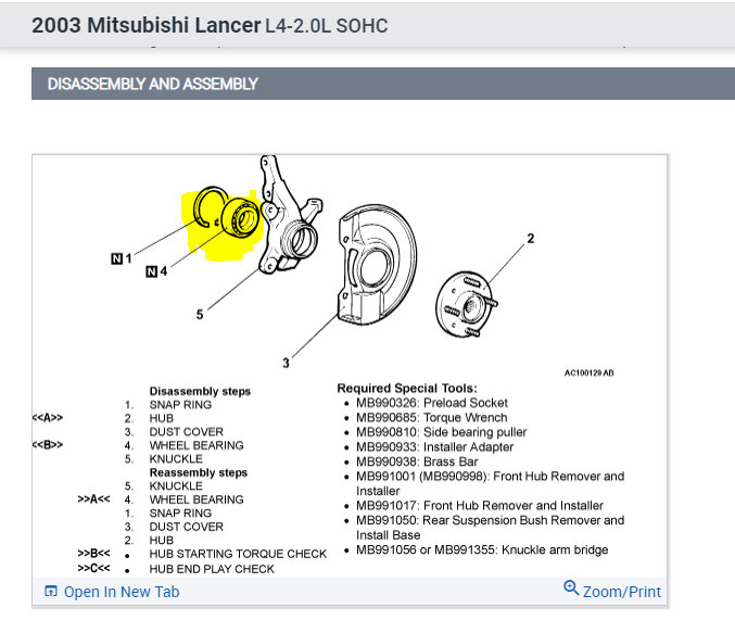

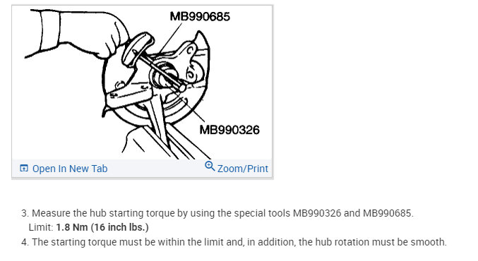

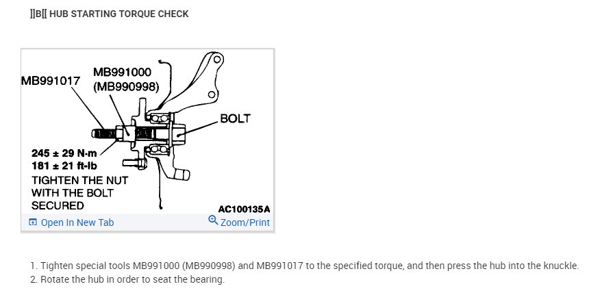

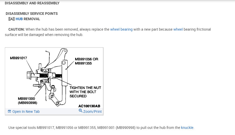

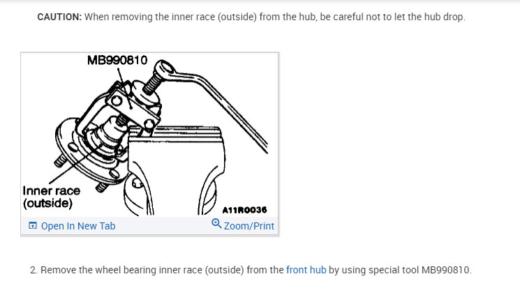

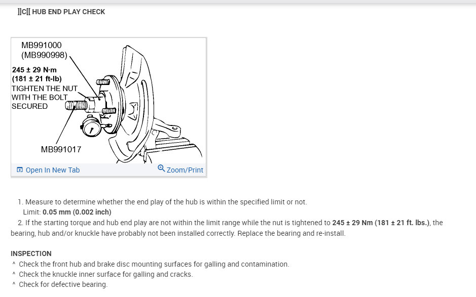

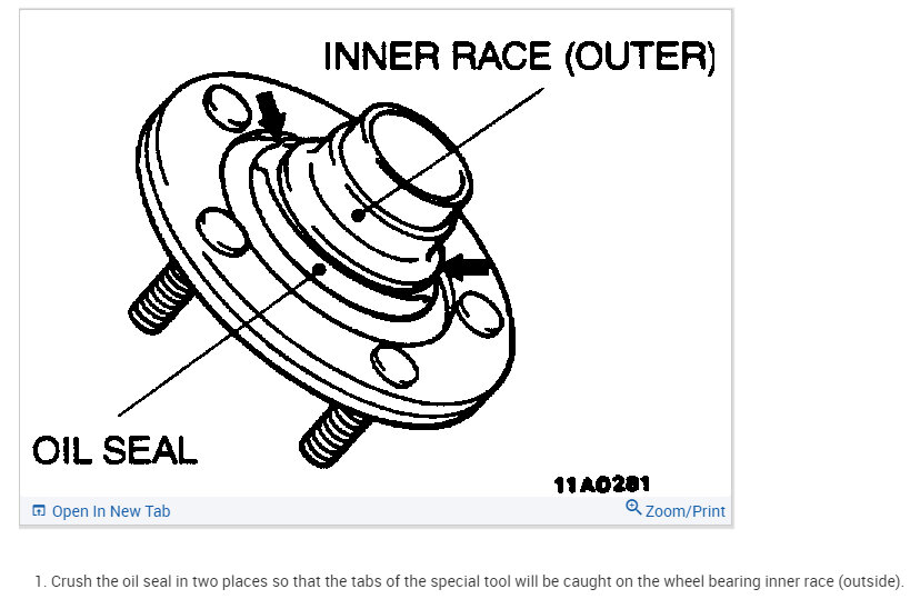

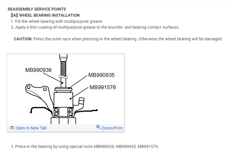

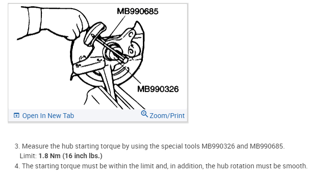

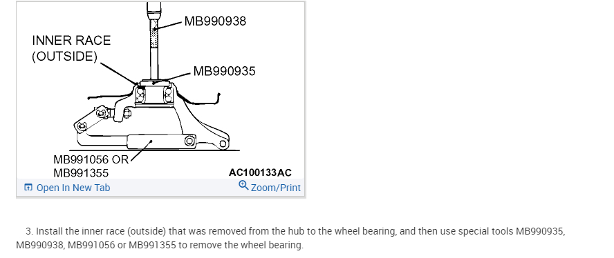

If everything is tight, the wheel bearing is my first suspect as well.
I'm not sure if you plan to do it yourself, but this has a press-in bearing and not a bolt-in. It takes a little longer to do and you will need a press.
I attached the directions below. Take a look through them and let me know if you have questions.

Thank you for the diagrams I was thinking of just replacing the whole wheel hub assembly since I don’t have the tools to remove and press in a new wheel bearing. it’ll be more expensive, but I think it’s also the easier route.
Apr 23, 2023 at 3:16 PM
  • 110,244 POSTS
There really isn't a hub to replace. The bearing is mounted in the steering knuckle. Do you mean you want to replace the knuckle? A new one likely will not have a bearing installed.
