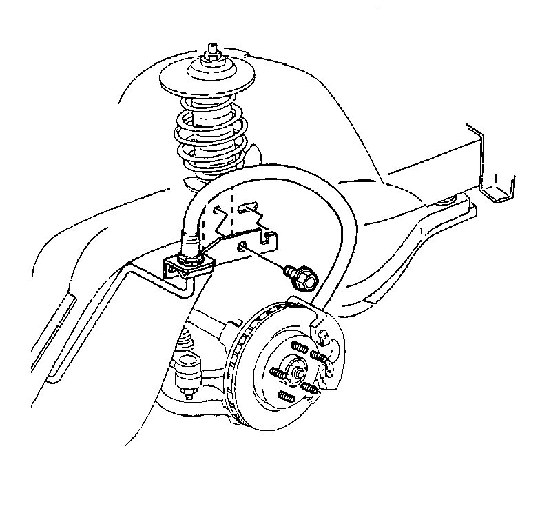

I changed the brakes rotors and calipers for both front wheels and master cylinder. i did a brake bleed and the cars fully up on stands. When i tried the brakes in the air to make sure they worked after the brake bleed the right wheel works the way it is supposed to but the driver side front wheel doesn't move at all either in neutral or drive. help please.

This happens when the brake booster push rod is adjusted out too far which does no allow the brake master to return fully holding the brakes on . To confirm the issue loosen the brake master mounting bolts 3 turns to see if the car starts to roll again, if so remove the master and adjust the booster push rod inward. Also a brake flex hose can come apart internally causing a short of check valve in the system but this is usually isolated to one brake either front or rear. I need you to check something. Since the calipers are new, try this. Pump the brakes so the front wheel locks. Release the brakes. Next, open the bleeder on the new caliper to see if the wheel will then turn. If it does, replace the rubber brake hose to the caliper.
When they get older, internally they break down and allow fluid to be forced through to actuate the brake, but the back pressure isn't there to release the fluid back to the master cylinder. If it releases when the bleeder is open, the hose is the likely cause.

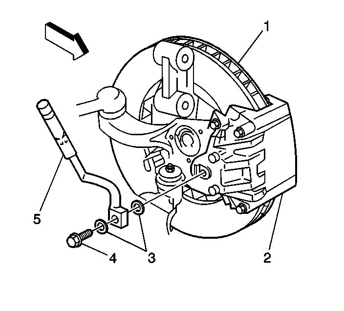

Here are directions specific to your vehicle for hose replacement. The pics below correlate with these directions.

7. Remove the brake hose to caliper bolt (4) from the brake caliper (2).
8. Remove the brake hose (5) from the brake caliper (2).
9. Remove and discard the two copper brake hose gaskets (3). These gaskets may be stuck to the brake caliper and/or the brake hose end.
