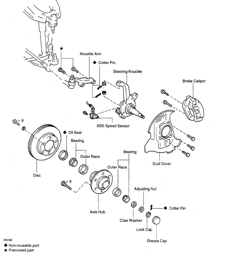

Recently retired with time to spare and would like learn and do as much work as I can on our three vehicles. Before I tear the wheel apart can you tell me if this vehicle has a hub assembly with already installed wheel bearings or are they something I need to install separately? Thanks!
Mar 8, 2019 at 1:42 AM
  • 55,399 POSTS
Here is a video of the job being done with a diagram below to help you see how the assembly is built and the parts needed to complete the job:
https://youtu.be/mOyHFT0hoKc
