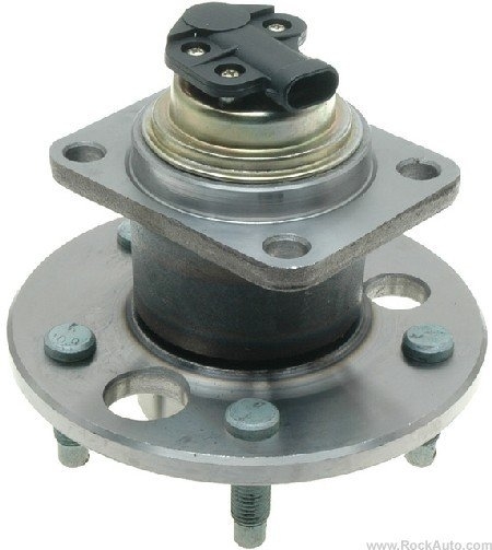

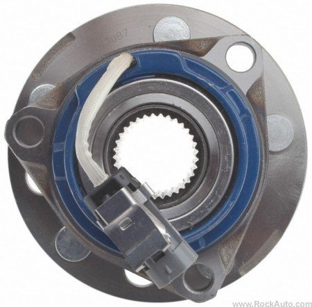

I have a running sound going down the road. I suspect a wheel bearing in the front, I can wobble the passenger side just a little, however I was wondering, is there wheel bearings on the rear also? Thanks in advance for any help. Steve
Sep 24, 2017 at 8:26 PM
STEVE W.
  • 15,347 POSTS
Wheel bearing on both ends. In fact the front and rear are very similar parts. Both are unitized hub bearing units. I added pictures below. The left one is the front bearing the right is the rear. The front bearing is a bit larger as it also steers and propels the car while the rear is simply a trailing axle and just supports the rear end.
If you feel any play in a unitized hub front or rear, the bearing is junk. Normally they will make a loud hum for a long time before you can detect any movement. That is from damage to the bearing race and the noise is the balls running over that damages point. Same basic reason why a rumble strip makes the sound it does.
They can be easy to change if you are not in a rust belt state.
https://www.2carpros.com/articles/bearing-hub-replacement
However, if you are in an area where you can hear your car rust at night. Things get much harder.
