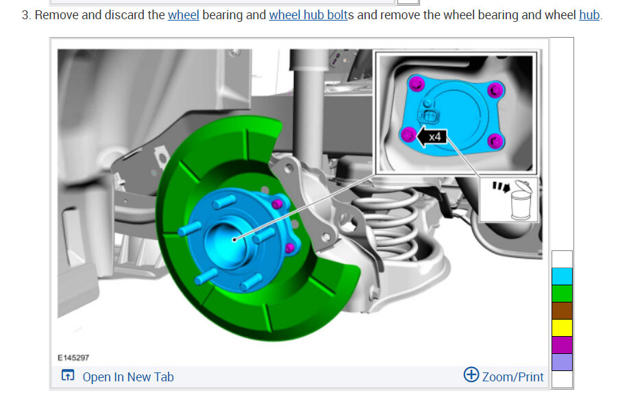

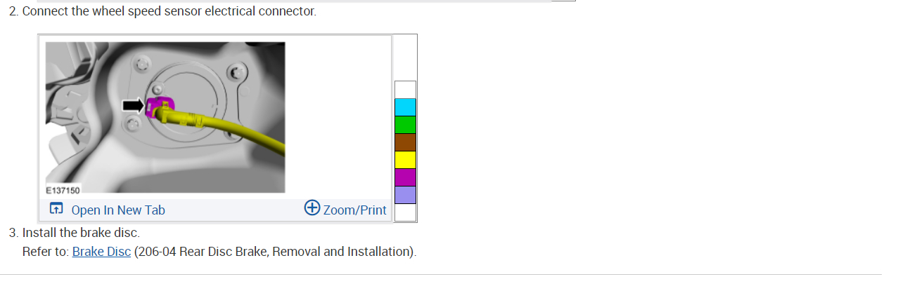

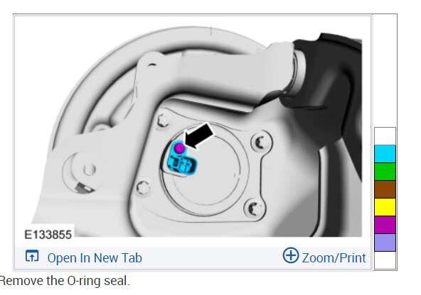

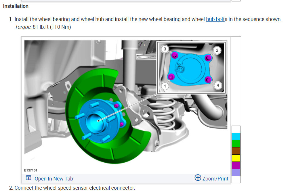

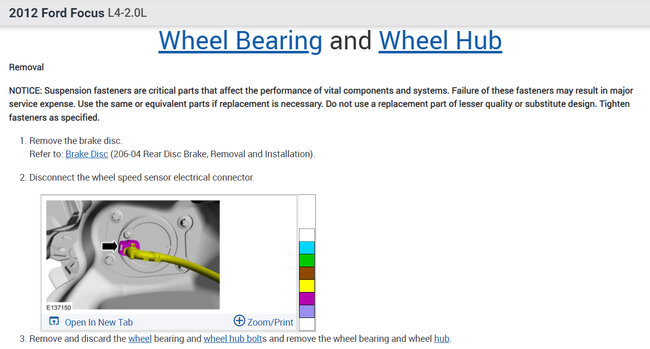

It sounds like you have a defective bearing hub, or they did not plug the sensor in which is part of the hub. When the ABS system is not working you will not have the hill start function. Can I ask which brand the part is? You should be able to do an ABS brake system scan to confirm the problem.
https://www.2carpros.com/articles/anti-lock-system-testing-and-repair-abs
Here is how the job should be done correctly. FYI, shops don't like it when you bring your own parts in even though they say it is okay. They like to be able to complete the job fully without these kinds of problems. Check out the images (below). Let us know how it goes.

It sounds like you got a defective part. The sensor can be removed separately you might should be okay to swap the sensor out.
