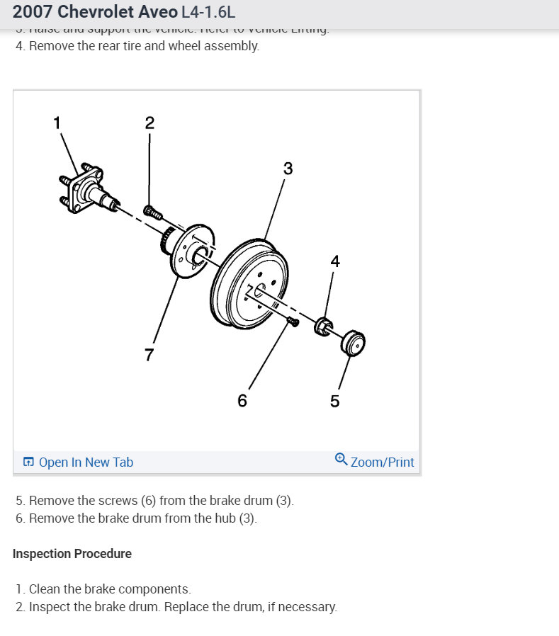

My back right car wheel won't turn when I'm accelerating or reversing.
Nov 15, 2022 at 4:51 PM
  • 55,423 POSTS
So, what happens is in wet weather the brake shoes can get stuck against the drum and not release. I would use a large hammer to strike the drum (emergency brake off).
Here is a video to help with diagrams in the images below to help you fix the problem:
https://youtu.be/UV0kfP17Co0
Check out the images (below). Let us know what happens and please upload pictures or videos of the problem.
