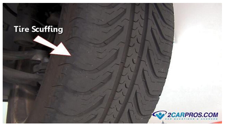

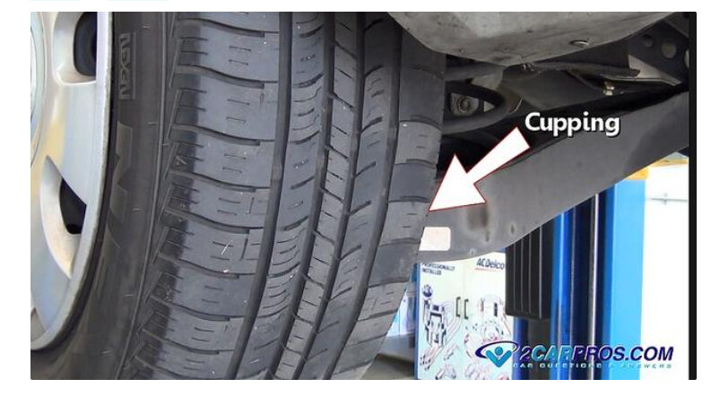

I do hear it. It is more noticeable in the second video. The sound can be an axle bearing, a carrier bearing in the differential or even the result of tire wear.
First, check the tires for cupping or feathering.
Take a look through this link to check tires:
https://www.2carpros.com/articles/how-car-tires-work
Also, I attached two pics from the link below that are specific to what can cause this type of noise.
If the tires are smooth, evenly worn, and have no high/low spots, then I need you to pay attention to see if the sound changes when making turns.
Also, check where the driveshaft attaches to the front yoke on the rear differential for evidence of an oil leak.
