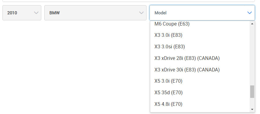

Hi guys,
This has been bothering me for some time. My close friend was charged $5,000 for a water pump replacement and new engine mounts to be installed by a BMW dealership near Silver Spring, Maryland.
She does not know anything about cars and trusts the dealership not to take advantage of her.
But this seems incredibly expensive for something I have done on my 1993 BMW E36 and which was relatively easy - although the engine mounts were a bit difficult and required the engine to be slightly lifted by an engine lift that was placed across the engine bay.
Do you know the rated number of hours to do this kind of work on this type of car? Even at $120 an hour, that would mean around 30+ hours of work plus parts!
Dec 4, 2023 at 11:23 AM
  • 110,194 POSTS

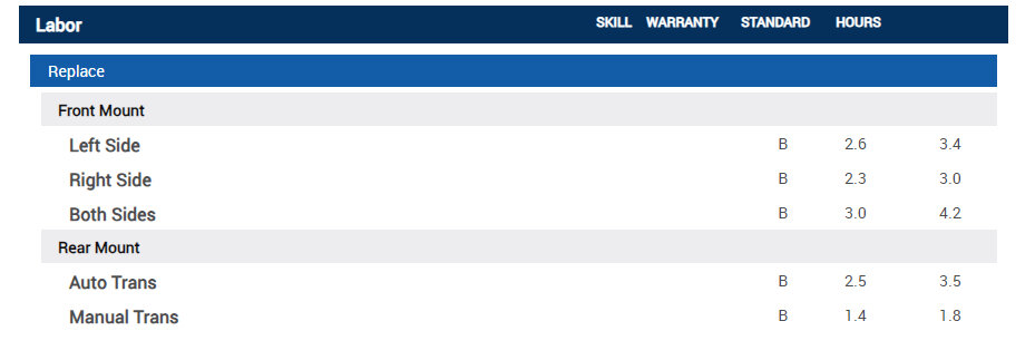

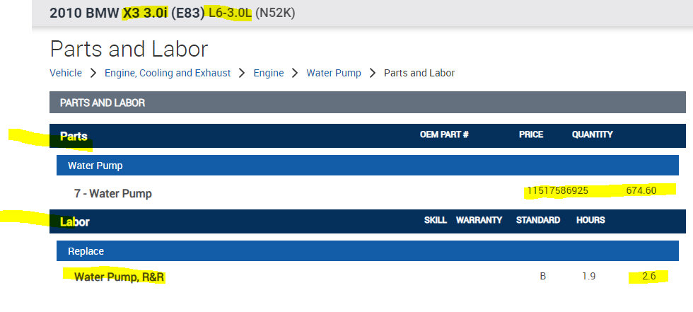

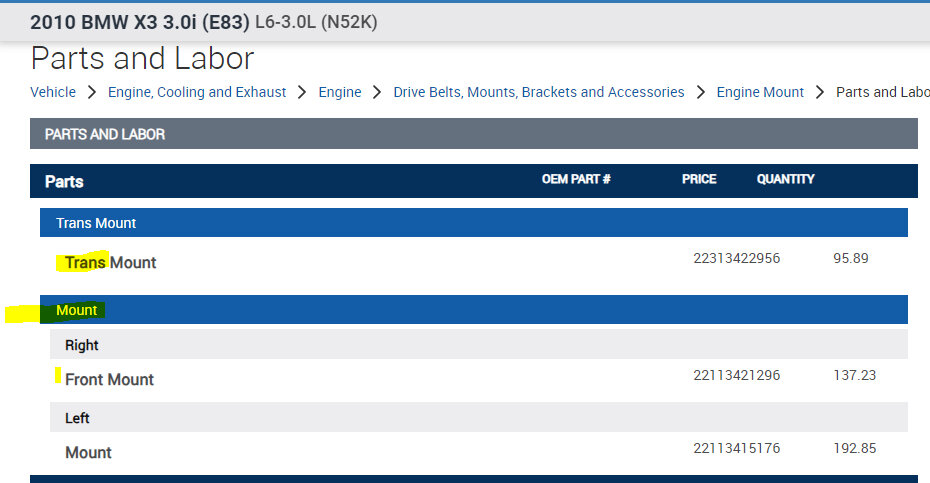

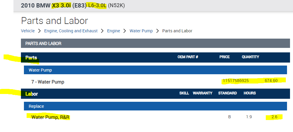

I'm not sure where you are located, but I'm not showing an X1 as an option. Both manuals start with an X3 with a 3.0L engine. See pic 1 below.
I attached parts and labor for the X3 with the 3.0L. Note that the prices on parts are for OEM parts. You can get them for much less aftermarket. Also, 30 hours of labor is nuts!
Take a look and let me know if this helps.
See pics below .

No problem whatsoever. I hope it helped. I went through my manuals, and it does not show the X1. However, the engine in the X3 is the same size so they can be too much different.
Take care and if I can help, let me know.
