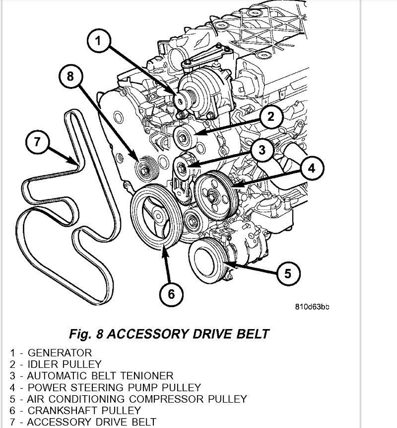

My AC compressor pulley is broken and I'm trying to find the right size belt to bypass it
Dec 7, 2019 at 1:14 AM
  • 55,423 POSTS

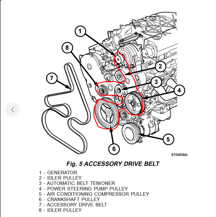

Though they don't have sizes for what you are asking but you can find the correct size by trail and error as long as you have a starting off point which is here and use the diagrams below to estimate how much shorter you need then the auto parts store can help. You may need to buy more than one and take the others back.
Serpentine Belt - 4861850AB - $14.70
I would estimate about 20 inches shorter. Check out the diagrams (below). Please let us know what happens.

AC compressor has locked up. I was going to get shorter belt to bypass the compressor. does anyone know the size belt it would take for a 3.5 engine?
Dec 9, 2019 at 2:04 AM (Merged)
HMAC300
  • 48,601 POSTS
this has to be done hunt and peck style at auto parts store there is no set belt for doing this.
MARK QUINN
Your right, but if anyone has the same problem and they will, it takes 80.5 belt from AutoZone!

I have a 2006 Pacifica with the 3.5 L and AWD. I used a 80 3/4 in belt. The part number is 060802 at Napa, box also says 6pk2038. I tried one that was 80 1/8 first, but it was too small. 80 3/4 seemed perfect.
STEVE W.
  • 15,347 POSTS
There are a few belts that will fit. The trick is to find the one that puts the tension-er the closest to its proper position. For that an 80 1/4 - 80 1/2 runs about right. The 6PK2038 listed above is an 80 1/2 inch pitch length belt. So it should work just fine.

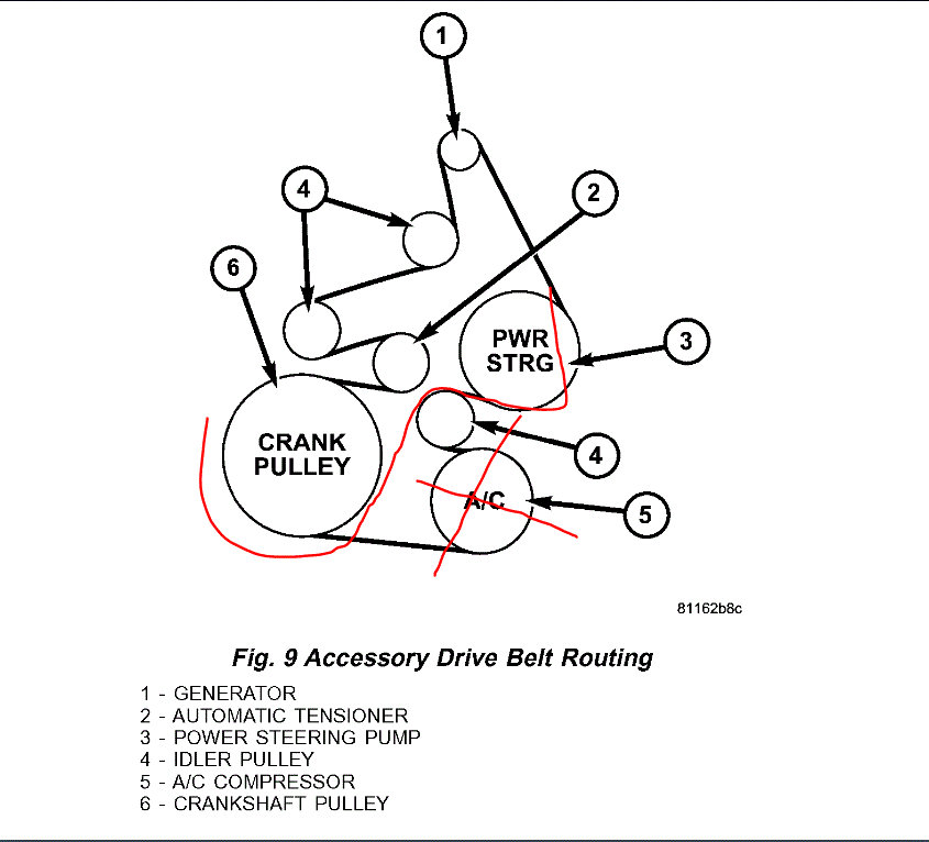

Would anyone be able to tell me or show me how to reroute the belt with out the A/C compressor?
Nov 10, 2020 at 12:09 AM
  • 110,244 POSTS
There isn't a specific predetermined way. However, I attached a pic below showing how I would at least try to do it.
Let me know if it helps.

Can I take the idle pulley off that's underneath the power steering? That's the only way that belt works for me because it seems to be about 3 inches to short.
Feb 8, 2022 at 6:25 AM
JIMMYCOOK05
I went and got the same belt everyone else has and tried routing it like the picture above, but it seems to be short. it's a 2006 Pacifica AWD, with the 3.5.
Feb 8, 2022 at 6:39 AM
  • 110,244 POSTS
I wouldn't recommend doing that. I feel the belt will slip at the power steering pump. Are you able to get a different length belt? Have you tried it bypassing that pulley?
Feb 9, 2022 at 5:59 AM
JIMMYCOOK05
I have my old belt and my new belt. The new belt will work on the lower half of that pulley but won't work over the top, it's still on. I just left it there until I can get back to it here in a couple days, I did leave the pulley on.
Feb 9, 2022 at 6:19 AM
  • 110,244 POSTS
Okay. Let me know if you are able to get the correct size and how things turn out.
Take care and let me know what I can do to help.
