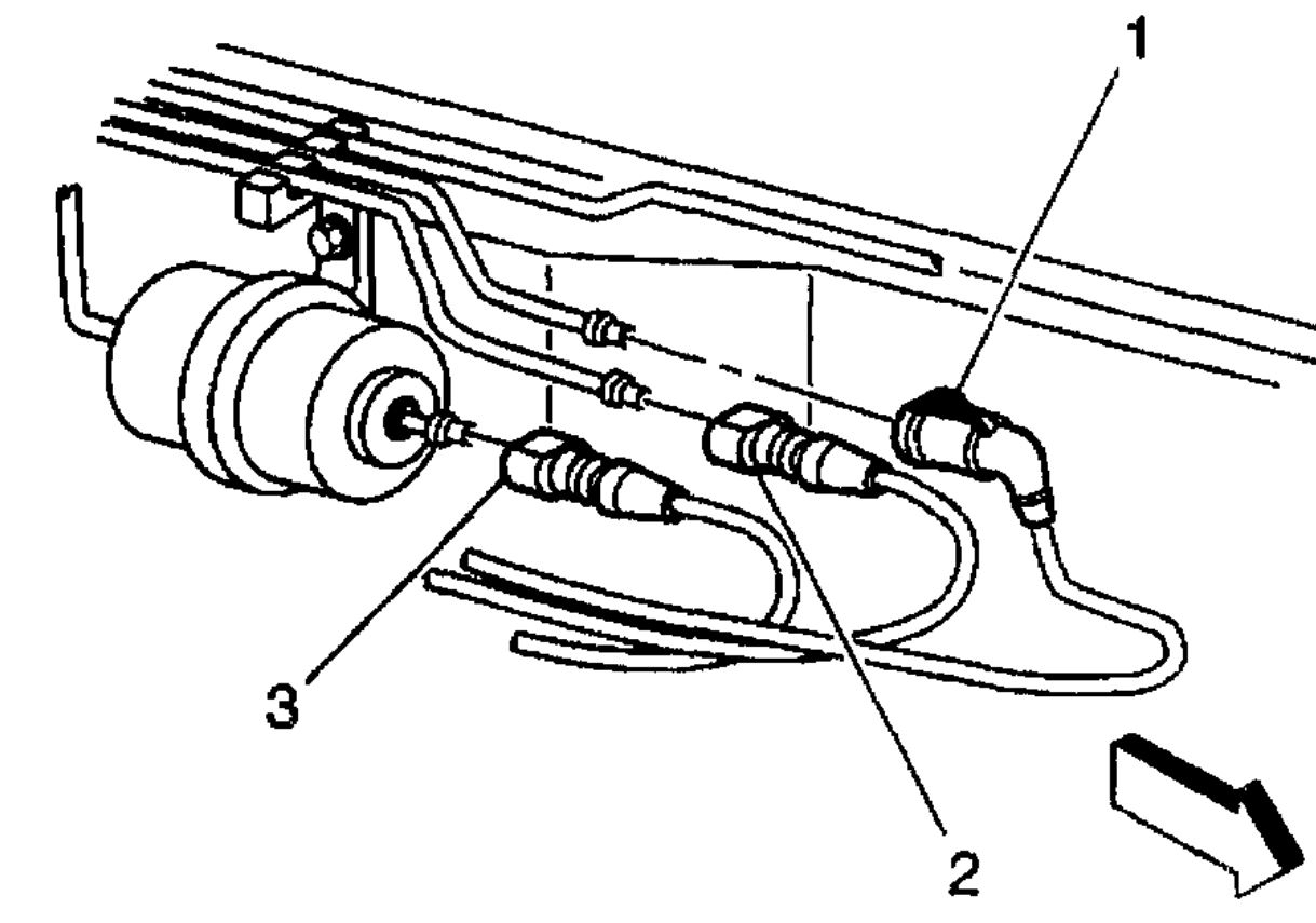

There are two filters in that fuel system that should keep any dirt in the tank out of the system. One is the sock filter inside the tank and the other is mounted to the frame rail below the drivers door. What is the issue you are having that makes you think you are getting dirt into the injector unit?

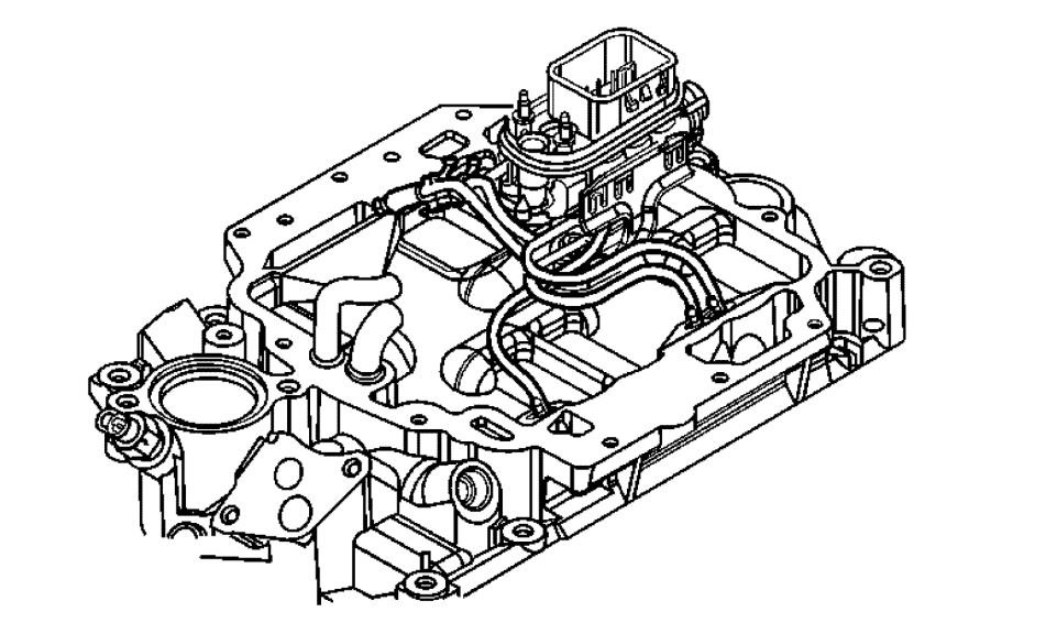

The upper cover has to be removed to gain access to the spider. It is not a difficult job but it is a tight job. Make sure you move everything out of the way when removing. Do not take short cuts. You have wiring and plastic vacuum lines that are fragile.

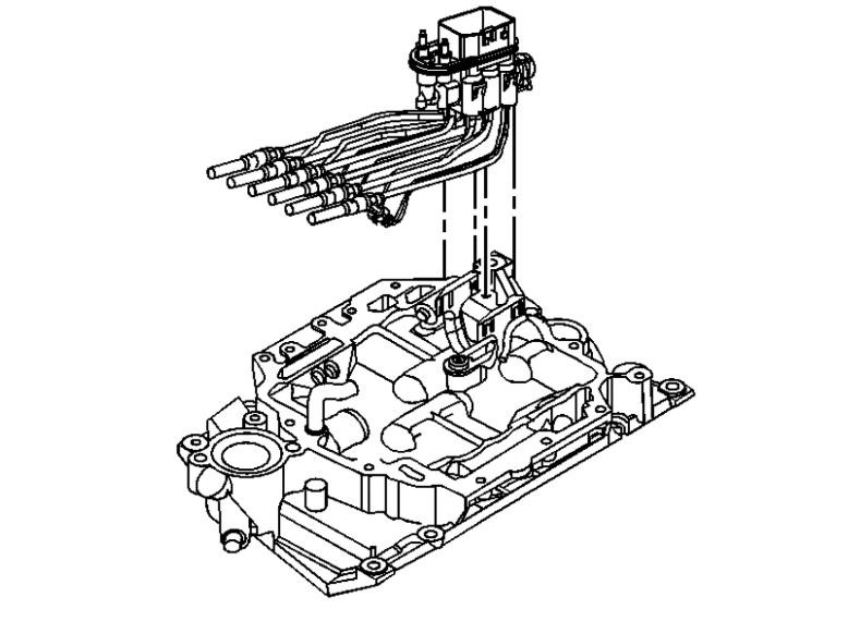

FUEL INJECTOR FUEL METER BODY REPLACEMENT
Removal Procedure
An 8-digit part identification number is on a mylar label affixed to the fuel meter body assembly. Refer to this number if servicing or part replacement is required.

4. Before removal, clean the fuel meter body assembly with a spray type engine cleaner, GM X-30A or the equivalent, if necessary. Follow the package instructions. DO NOT soak fuel meter body assemblies in liquid cleaning solvent.
Notice: Cover the injector sockets in order to prevent dirt and other contaminants from entering the open fuel passages.
Important: When disconnecting the injectors, remember the sequence in order to ensure correct injectors placement to each cylinder.
5. Lightly pull on the injector tube and use a small pocket screwdriver to remove the injector from the manifold.
6. Remove the fuel meter body from the bracket by releasing the lock tabs on the bracket.

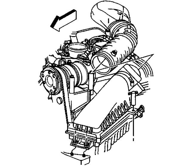

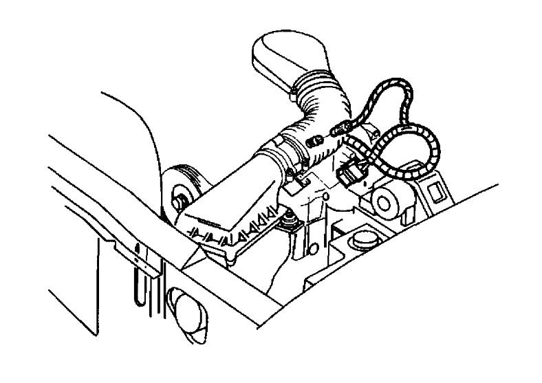

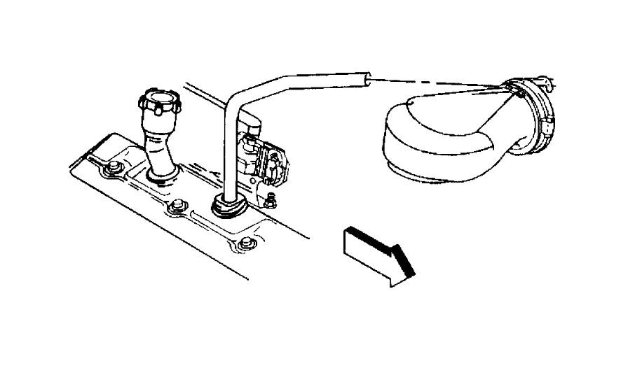

1. Disconnect the breather tube at the air cleaner outlet duct.

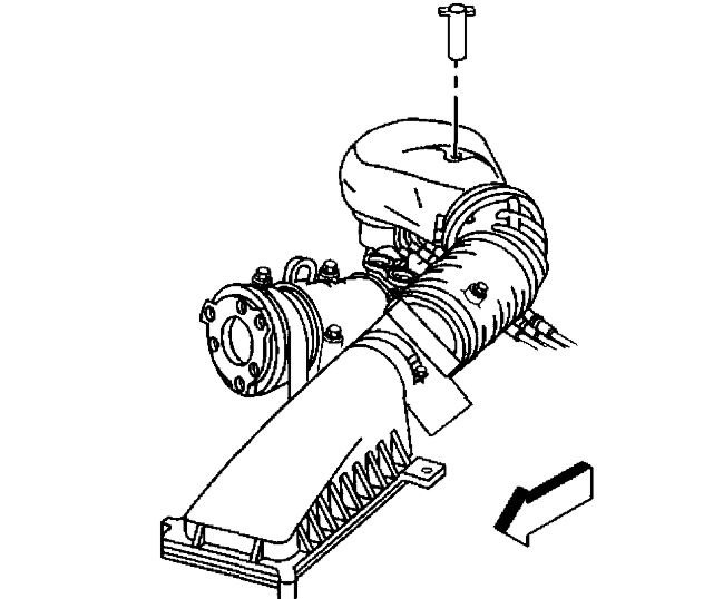

2. Remove the air cleaner outlet duct retaining wingnut.
3. Disconnect the IAT sensor harness connector.
4. Remove the air cleaner outlet duct from the throttle body.

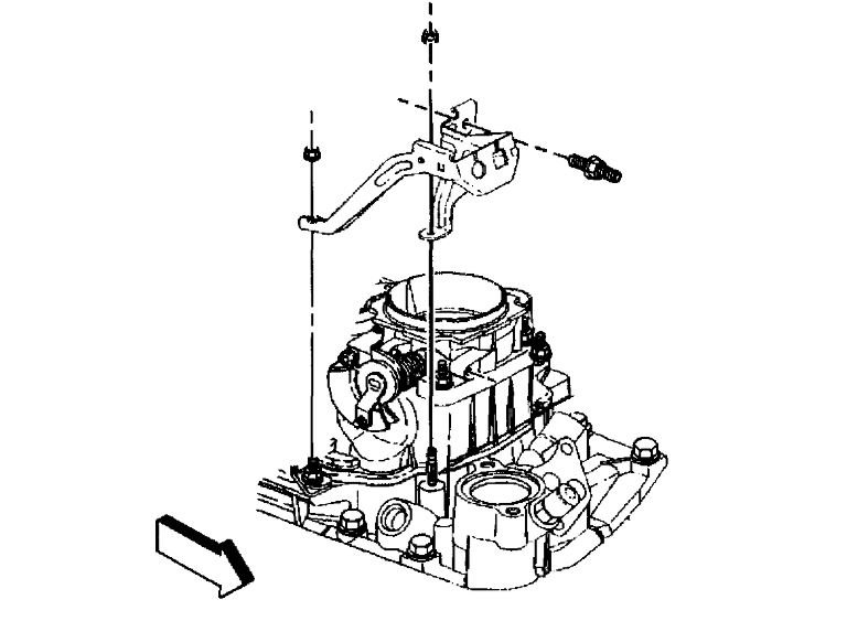

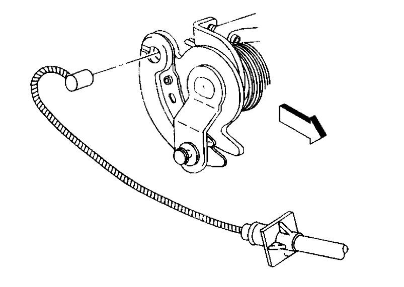

5. Disconnect the accelerator cable from the throttle body.
6. Remove the accelerator cable from the accelerator control cable bracket.
7. Disconnect the cruise control cable, if equipped from the throttle shaft and the accelerator cable bracket.

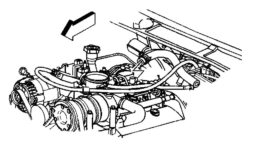

8. Disconnect the vacuum hose from the intake manifold for the vacuum tank.
9. Remove the power brake booster vacuum hose.

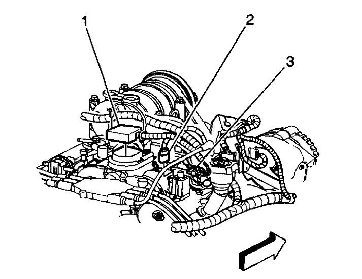

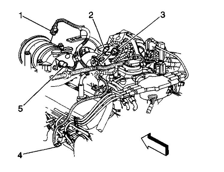

10. Disconnect the following electrical connectors:
The A/C compressor clutch (1)
The A/C compressor cutoff switch (5), if equipped
The Throttle Position (TP) sensor (2)
The Idle Air Control (IAC) motor (3)
11. Disconnect the following electrical connectors:
The fuel meter body assembly (1)
The Manifold Absolute Pressure (MAP) sensor (3)
The EVAP canister purge solenoid valve (2)

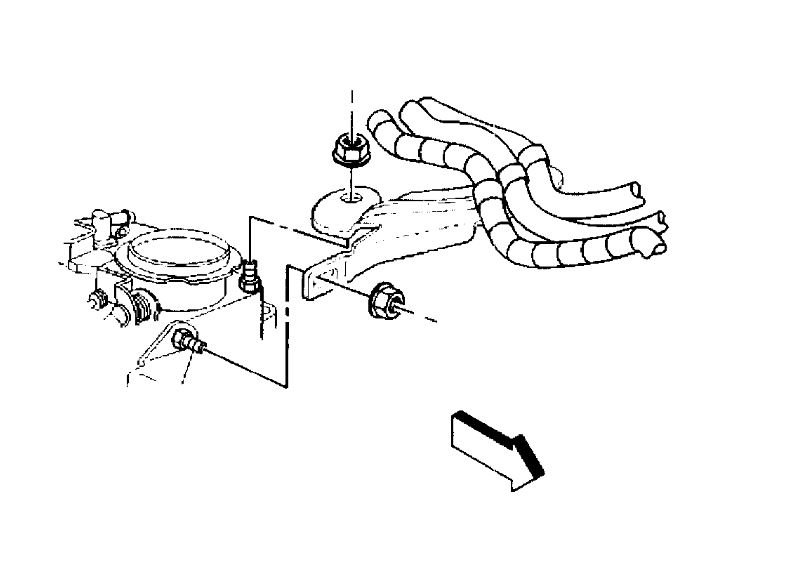

14. Remove the accelerator cable bracket from the throttle body and the intake manifold.
15. Remove the accelerator and cruise control cable bracket from the throttle body. Leave the accelerator and cruise control cables on the bracket.

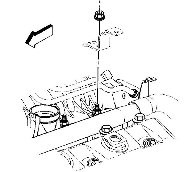

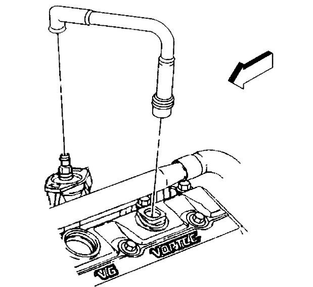

16. Remove the PCV valve hose assembly from the intake manifold and the valve rocker arm cover.
17. Remove the bracket for the engine wiring harness from the intake manifold stud.
18. Remove the fuel lines from the fuel meter body assembly.

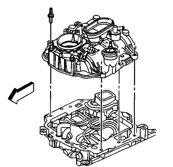

20. Remove the studs for the upper intake manifold.
21. Remove the upper intake manifold.
22. Remove the upper intake manifold gasket from the groove.
23. Discard the gasket.

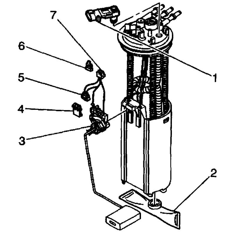

This sounds like the fuel pump itself if you have to bang the tank for it to work.
https://www.2carpros.com/articles/how-to-replace-an-electric-fuel-pump
May 24, 2020 at 12:22 AM
STEVE W.
  • 15,352 POSTS
As Roy stated that is very likely the pump itself. They are a known failure item on GM trucks. The bang the tank test is one you can use to verify it's the pump. The impact moves the pump just enough sometimes that it works again. In your case you have already proven it's the pump. The only hard part on replacing the pump in that truck is getting the tank out to work on it. Do not buy a cheap pump though, there are a lot of low cost ones but you don't want to need to replace it in another year because it failed again. I try to use Delco pumps whenever possible. Be aware that the 2 door and 4 door use different pumps as well. AC Delco MU1760 is the 2 door pump, AC Delco MU1733 is the 4 door unit.
Those will come with a replacement wiring pigtail as well to repair the commonly damaged original connector.
The article Roy linked has some good info on the process. There are also a number of videos on YouTube showing the process just search - blazer fuel pump replacement
