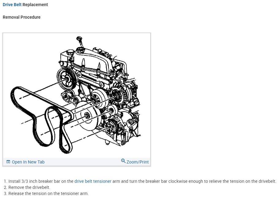

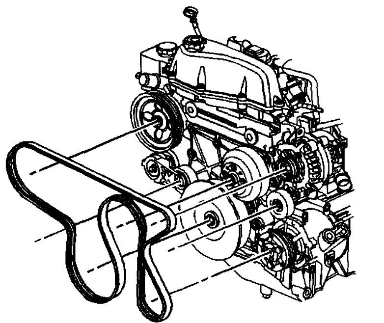

What is this noise?
Jan 18, 2020 at 11:34 AM
MASTERWRENCH
  • 258 POSTS

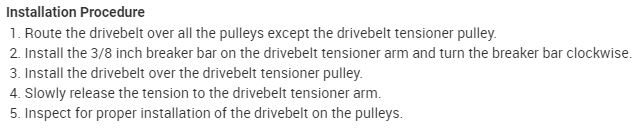

Hard to say for sure. I would start by removing the serpentine belt, then run the engine for a short period of time to see if the noise is still there. If it's gone, you know it's one of the accessories that runs off the belt drive. Attached is a picture of the belt routing and the remove and install procedure for the belt. Let me know what you find!
Jan 18, 2020 at 3:22 PM
GOLFERKING
It is the A/C compressor.
