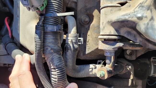

This hose has a pin hole leak.
Jul 7, 2023 at 10:18 AM
  • 110,244 POSTS
I need to know which hose. Is it leaking anything? What does it connect to?
If possible, could you take a couple of pictures and upload them for me to see?
Jul 7, 2023 at 1:58 PM
DOWENS1066
Let's see if this picture will come through this time.
Jul 8, 2023 at 2:28 AM

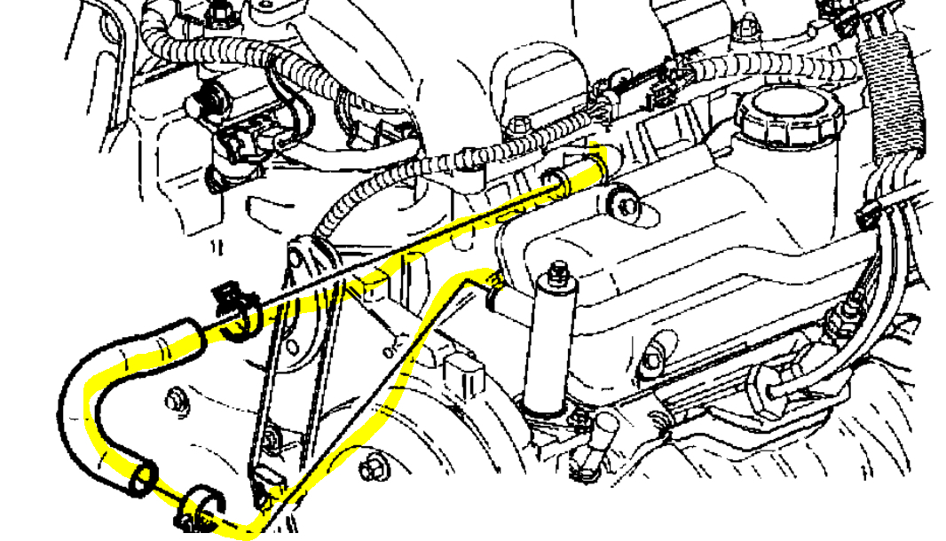

The coolant hose, both a rubber hose and steel tube, is the thermal bypass hose/pipe. See pic below. Is it leaking or what is happening?
See pic below.

Thanks! It was leaking through a pinhole sized crack. When I took it off, it was super spongy, and turned out to have large cracks in the inside radius of each corner. It was probably the original one. I got one from NAPA and cut it down just a little bit to make it fit perfectly.
Thanks again for your help!
