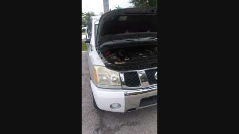

I am including a video to help show what I mean.

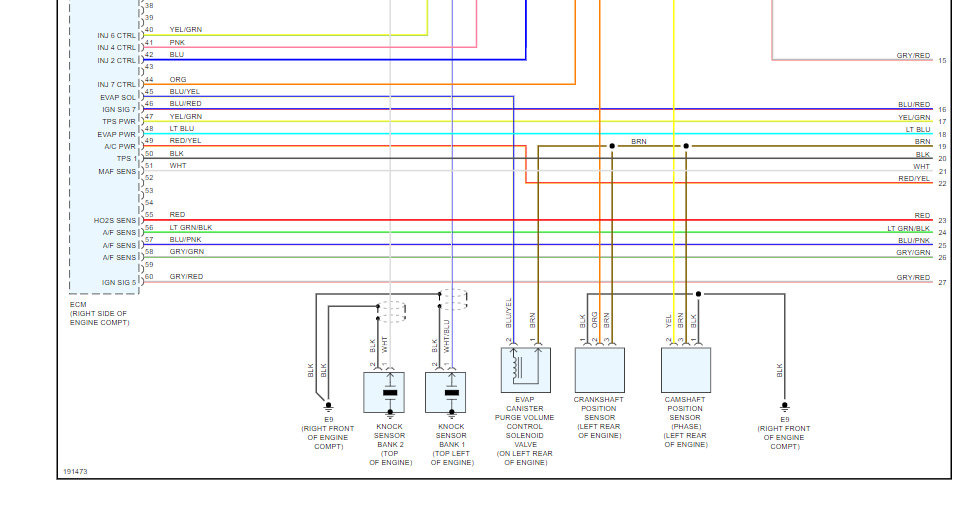

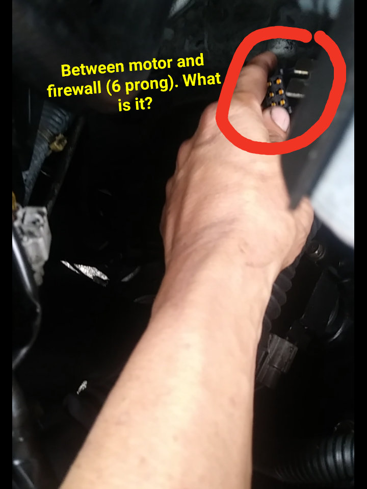

I cannot find any schematics showing what wiring system is just in front of the passenger seat in the motor compartment.
I checked connections with a testing light and one came up bright and another one very dim or even blinking.

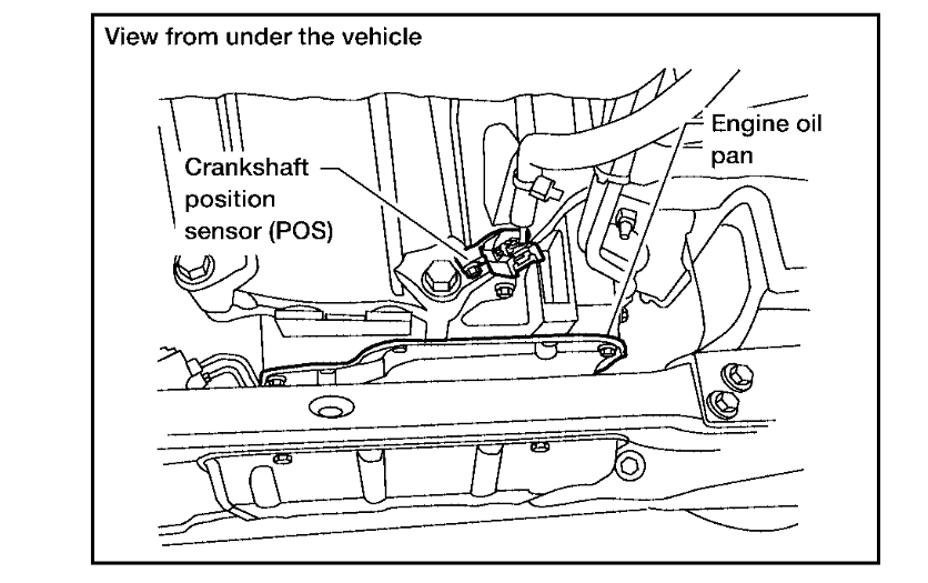

My code reader still gives me a p0335 generic. Crankshaft position sensor "A" circuit
and manufacturer control.
If you could help me decipher what the wiring connection is in front of the passenger area by the motor that would be a great help.

What does the connector hook to? What component?
I attached the wiring diagram for the crank sensor. Verify power to the sensor brown wire.
