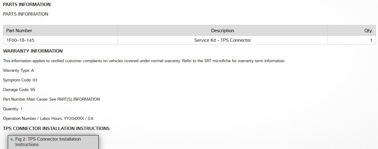

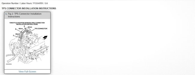

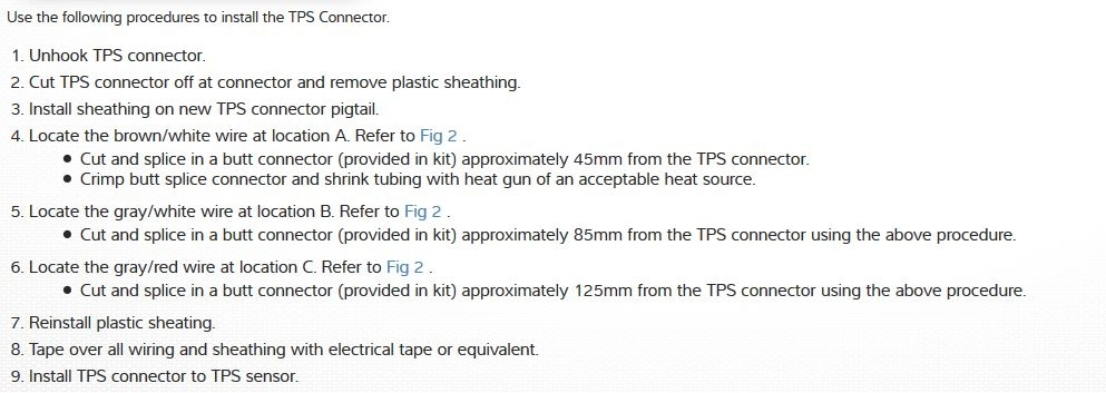

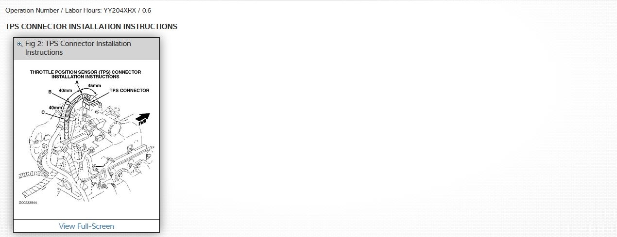

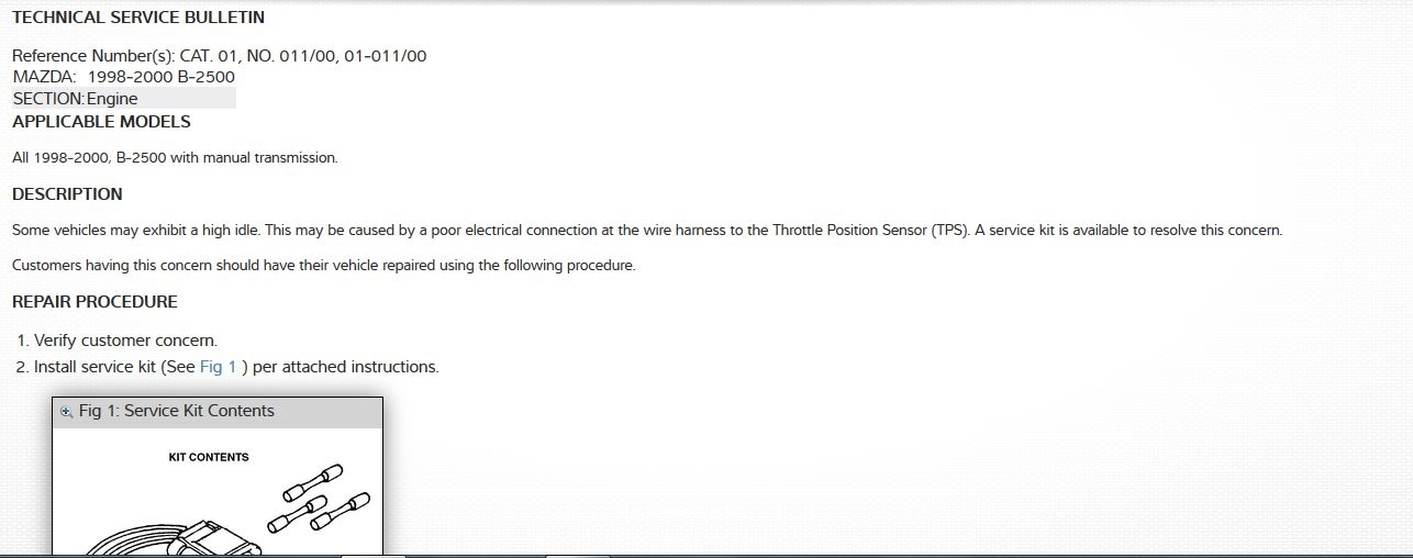

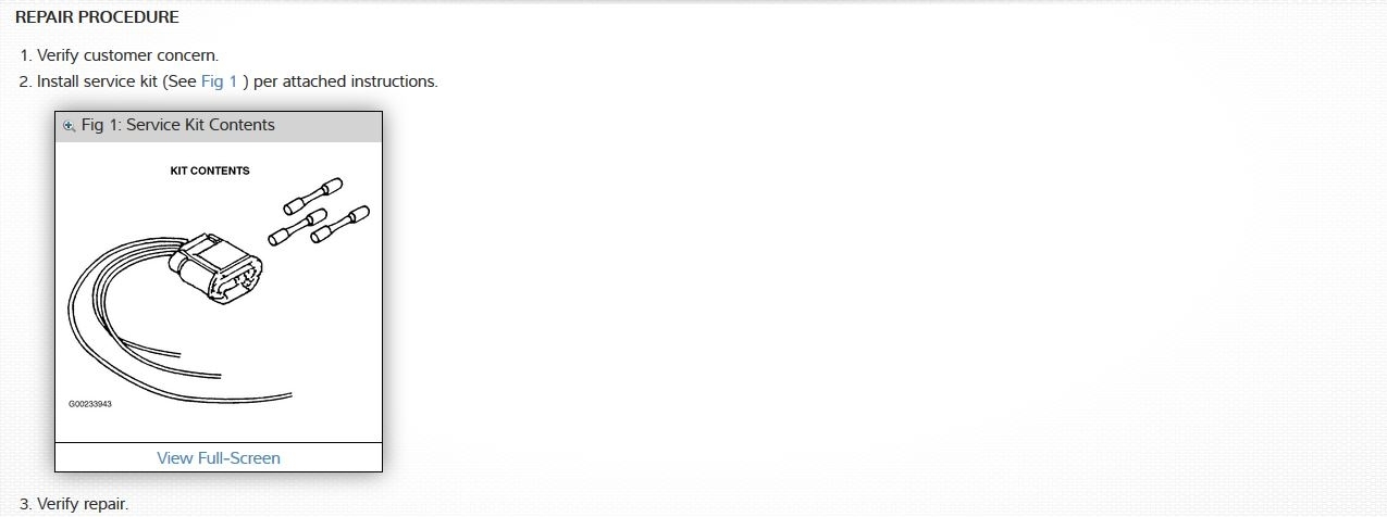

And then I found this. It could be caused by a bad connection at the throttle position sensor. Here is the service bulletin released by Mazda.
