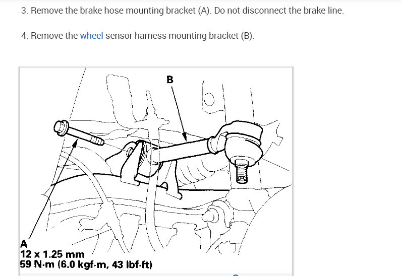

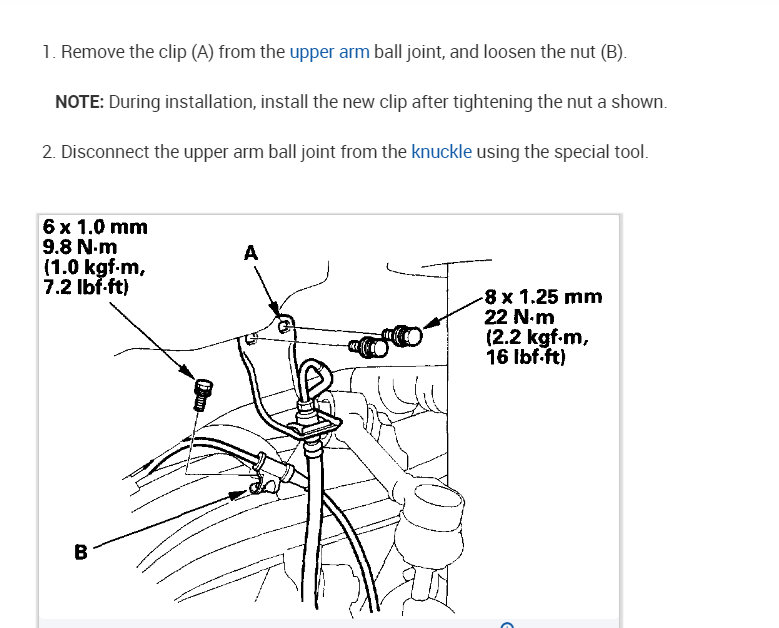

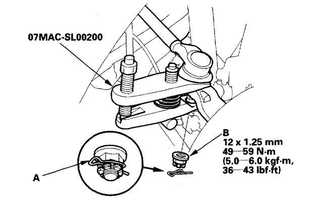

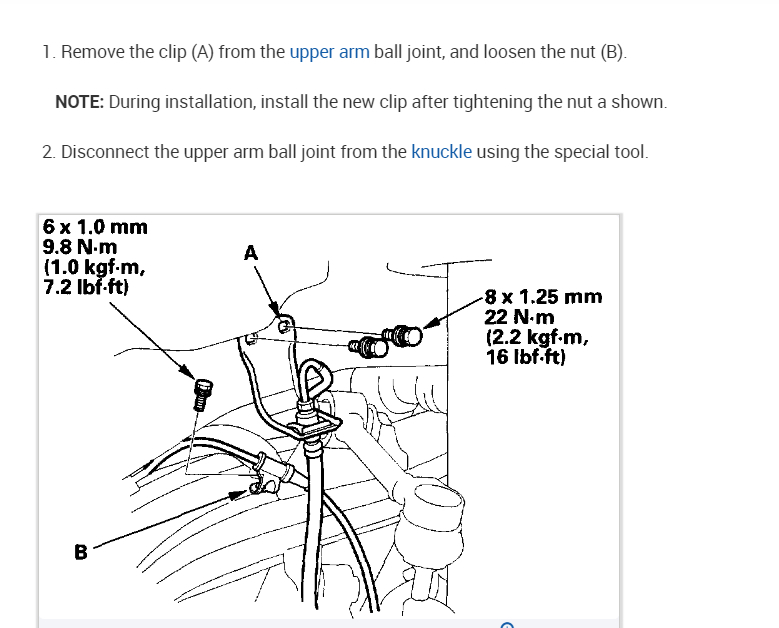

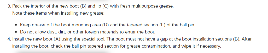

What are the torque specs for front suspension
2003 HONDA ACCORD
178,000 MILES • 2.4L • 4 CYL • 2WD • AUTOMATIC
XNOTCH

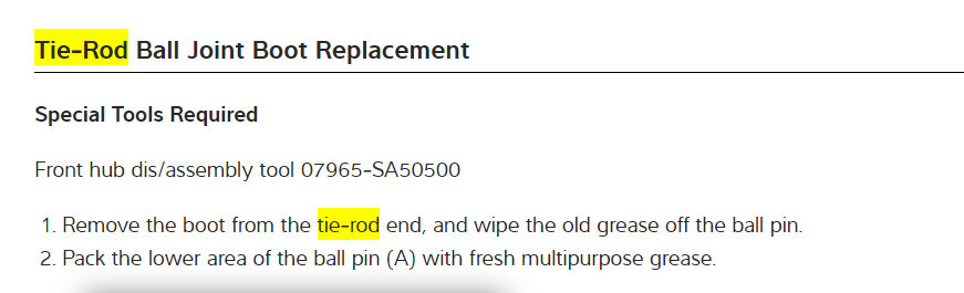

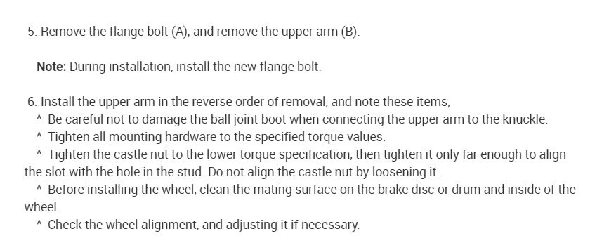

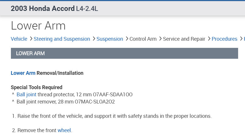

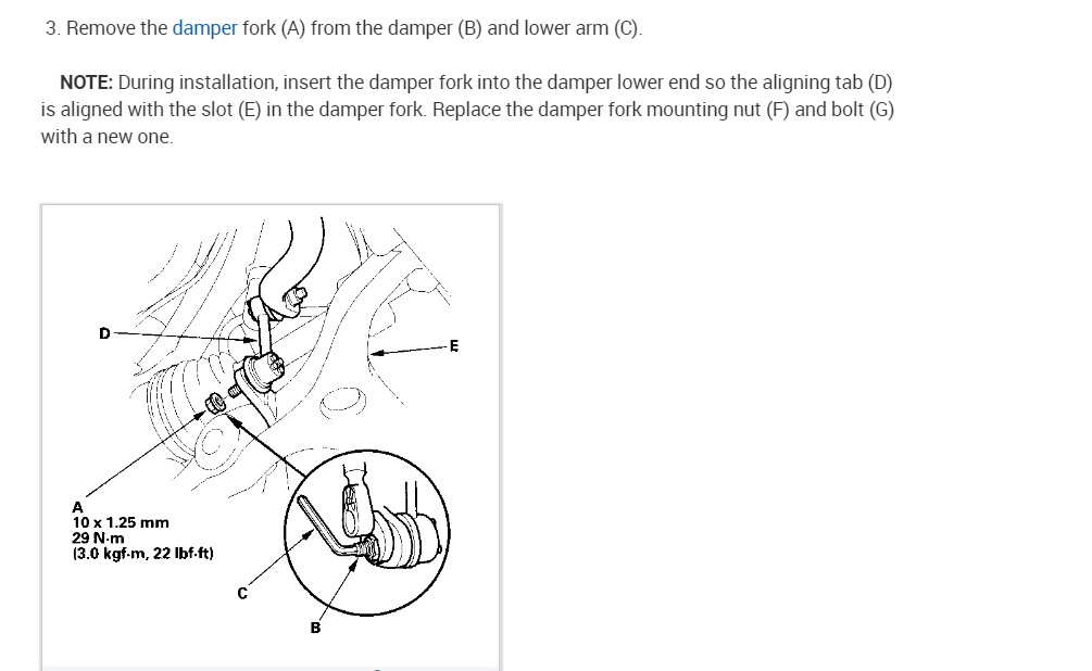

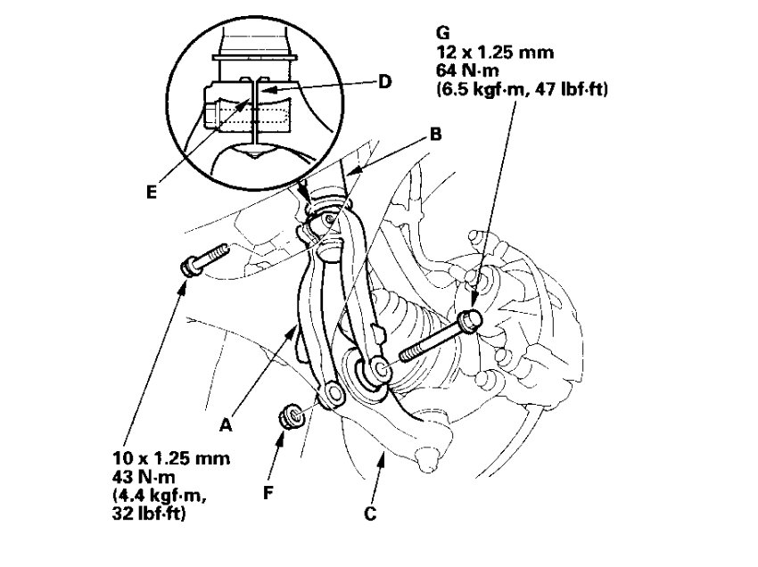

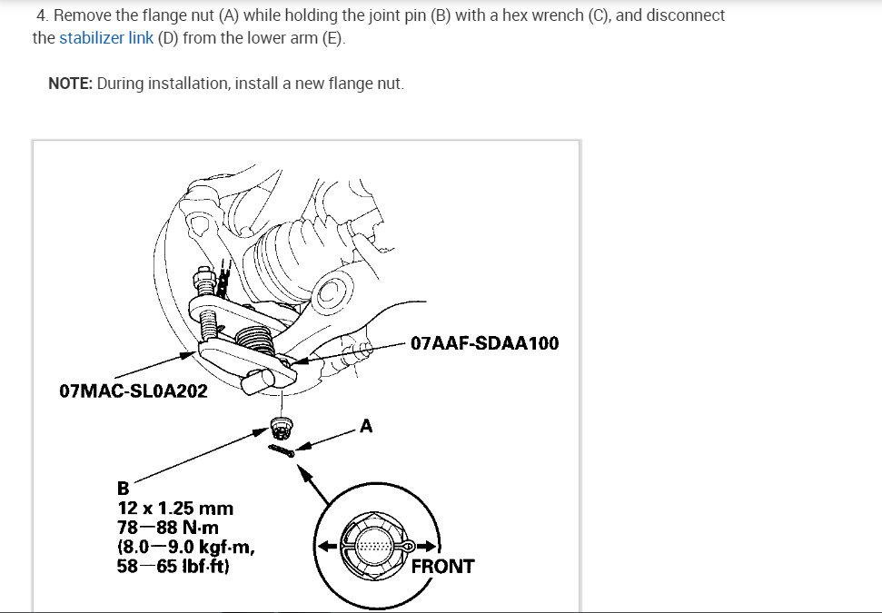

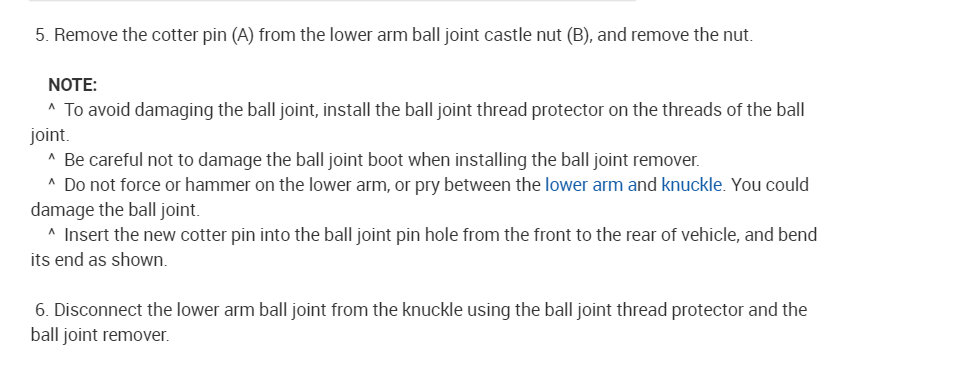

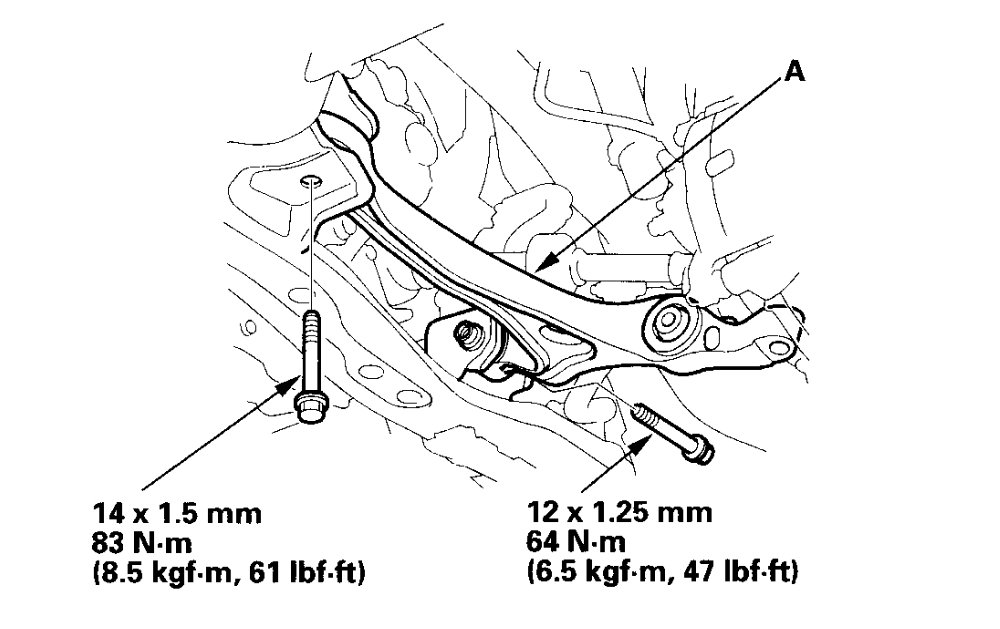

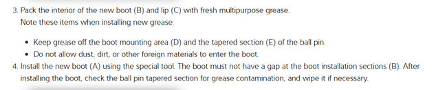

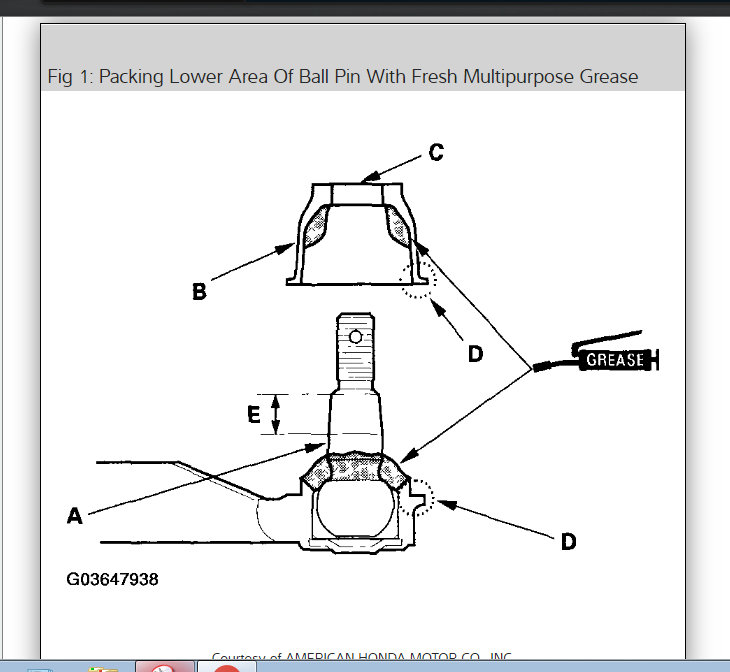

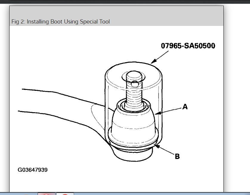

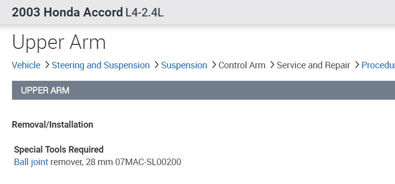

Getting ready to put in a new upper and lower control arm, sway bar link, lower ball joint, and tie rod. I’m using the same fork for the strut. I’m aware some need to be torqued down to spec but i don’t have that information.
Jul 30, 2019 at 12:14 PM
SCGRANTURISMO
  • 4,897 POSTS
The information that you requested is in the diagrams down below. Please go through these guides and get back to us with how everything turns out.
Thanks,
Alex
2CarPros
Jul 31, 2019 at 6:36 AM
XNOTCH
Thank you! This was a good reference for the job.
