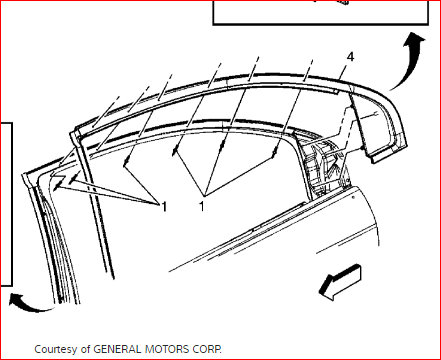

I do not get a lot of rain but I went through the car wash today and I heard water sloshing around and now just my passenger rear floorboard is soaking wet! Any recommendations on what is going on? I do have a sunroof and no rear AC.

It is possible the the door seal may be leaking. I have attached a picture for reference. Maybe at home you could simulate the leak by using a garden house with someone inside the car looking while you spray the sunroof and doors to see where it is leaking. Just a thought. Hope this helps and feel free to ask any questions if needed. Thanks for using 2CarPros.
