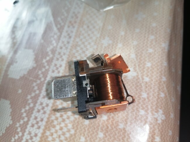

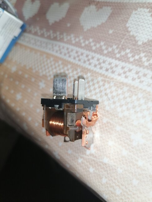

Could it be an ignition relay in passenger compartment under the dash? I removed it and tested with led headlight bulb, it works, but it is very low amount of amperage...pictures below are from its contact point.

Is there a different relay in the box that has the same part number? If so, switch them to see if it makes a difference.
As far as using low voltage to test it, sometimes they fail when they are under a load. So, the low voltage may or may not be accurate. Take a look through this link that explains how to test the relay and circuit:
Let me know if that helps.

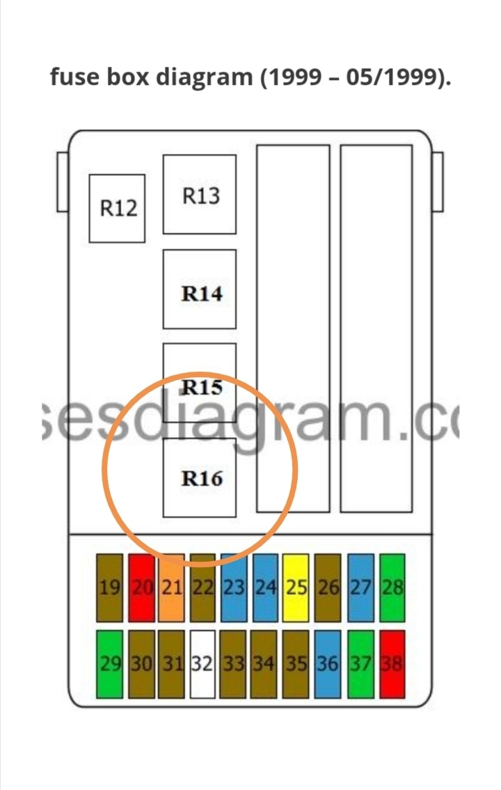

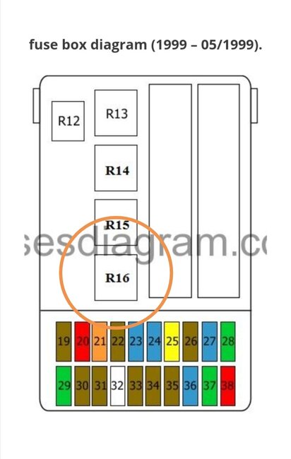

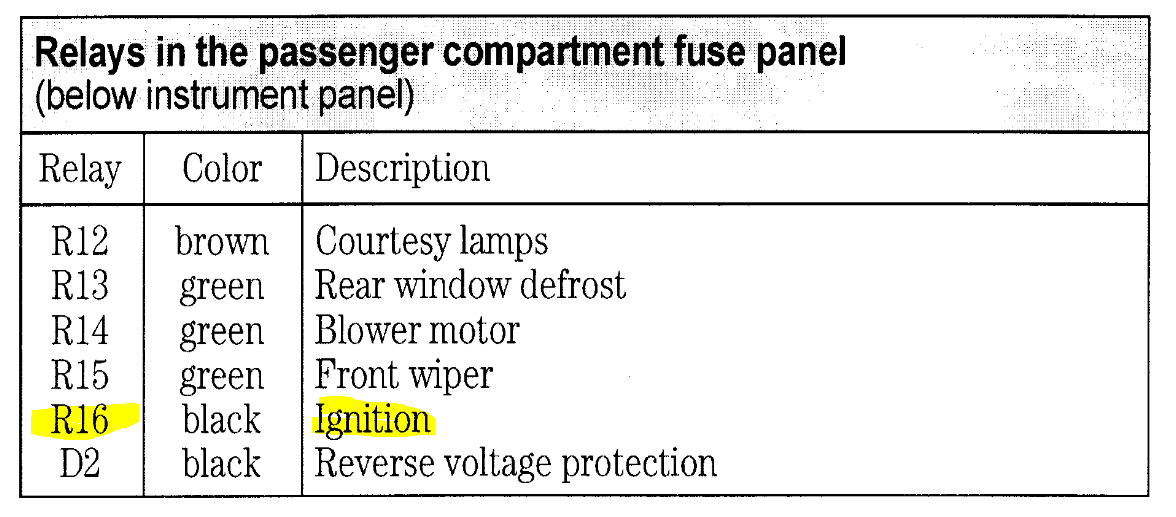

If you don't mind I would just once more please you to send me a diagram of its relay, to be able to know exactly what consumers powers through it. Thanks in advance.
Apr 5, 2024 at 3:26 PM
  • 110,244 POSTS
No problem whatsoever. I attached a list of the relays in the interior fuse/relay box. It appears that relay 16 is the ignition relay.
I hope this helps.
See pic below.
