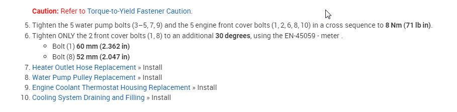

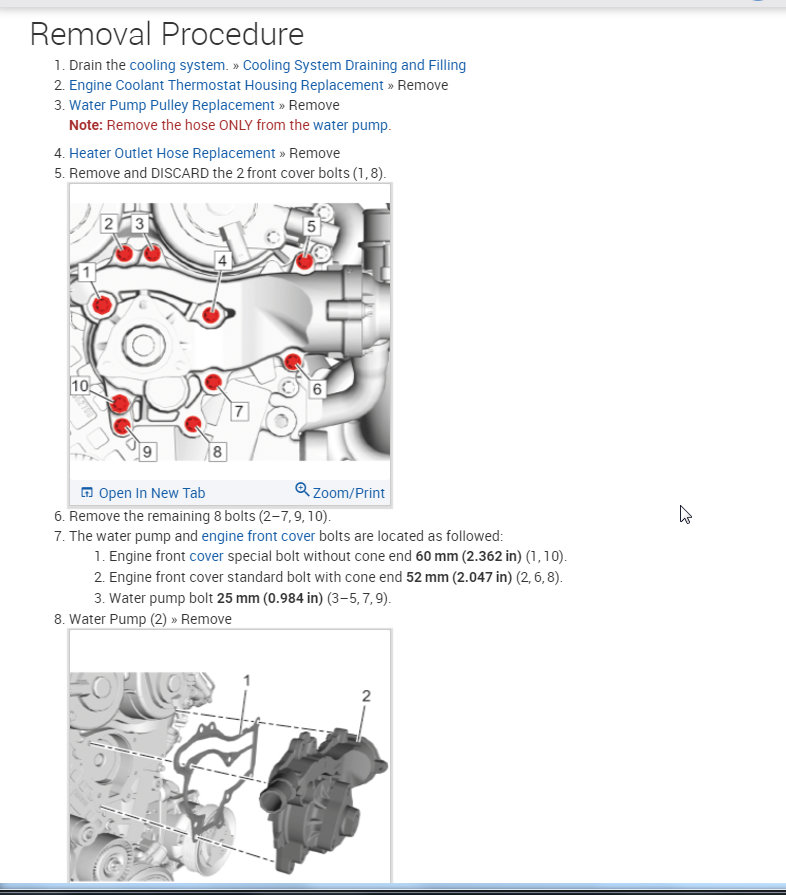

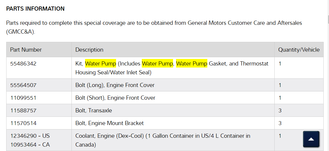

Do you have to change the thermostat when you replace the water pump? what are the torque specs on pulling back to water pump?
Apr 4, 2019 at 10:19 AM
SCGRANTURISMO
  • 4,897 POSTS

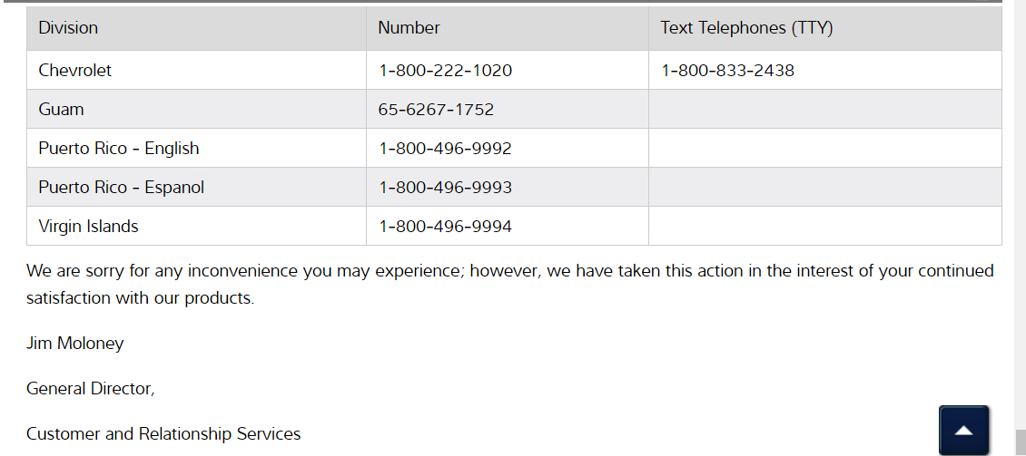

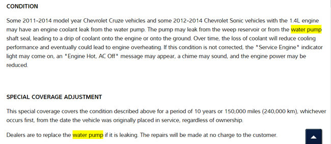

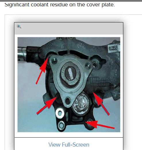

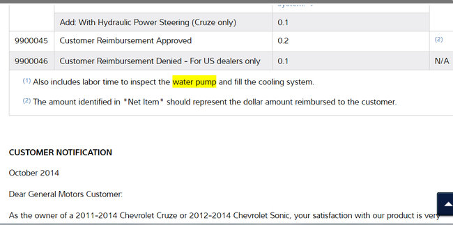

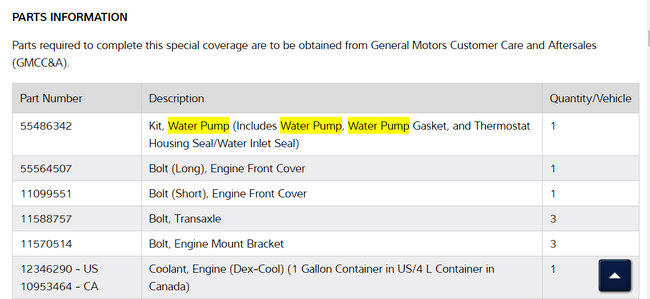

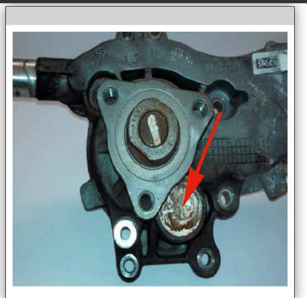

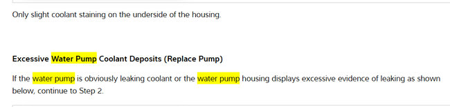

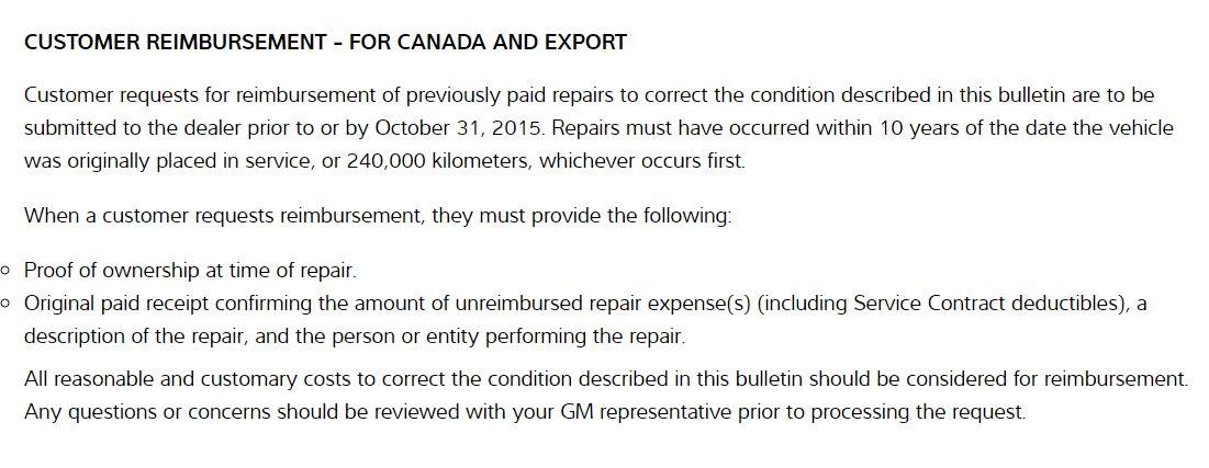

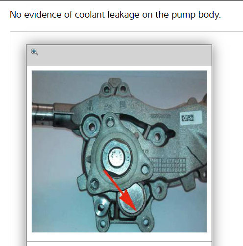

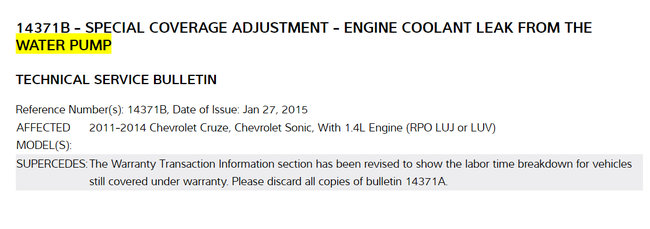

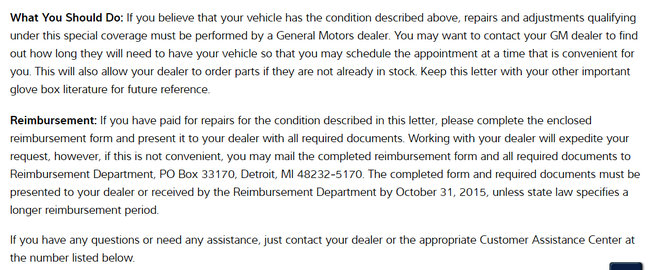

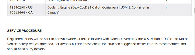

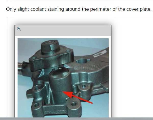

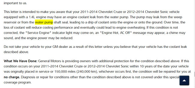

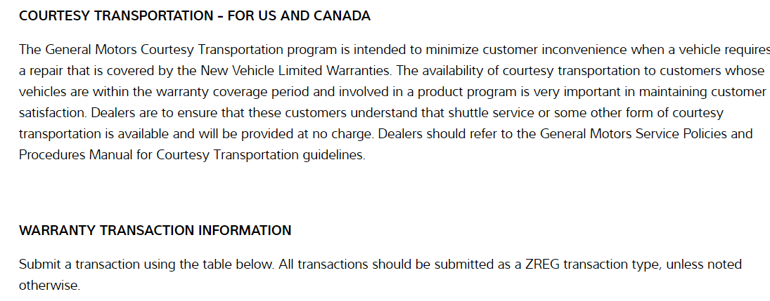

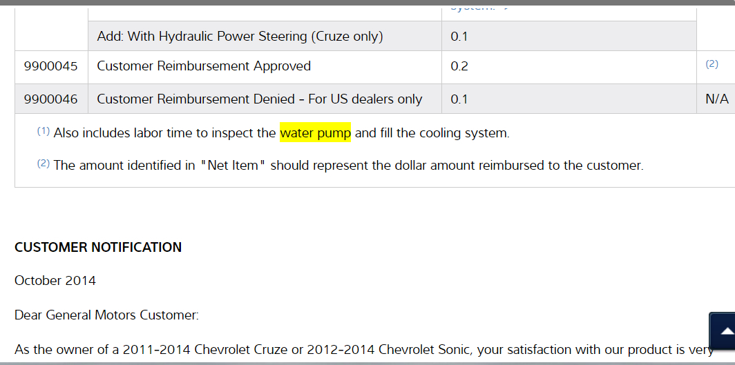

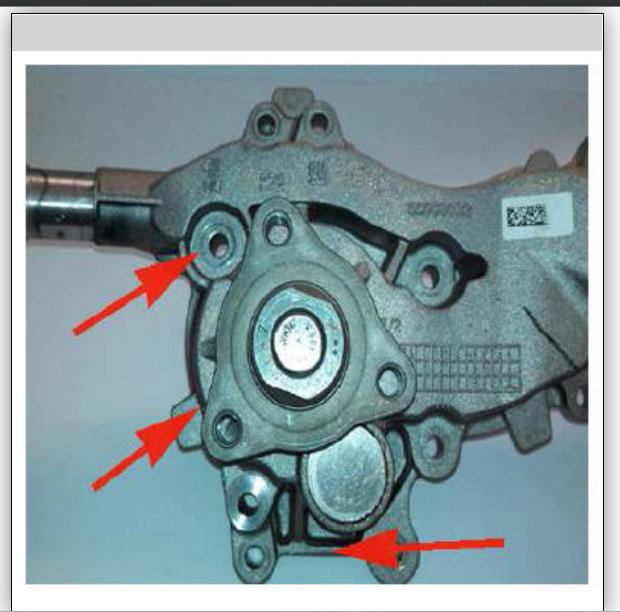

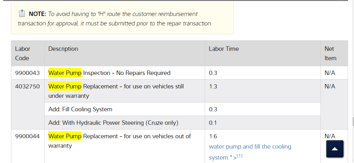

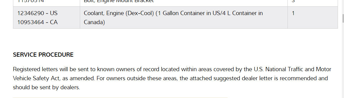

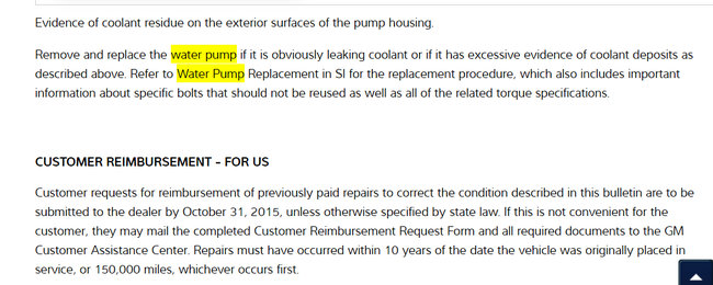

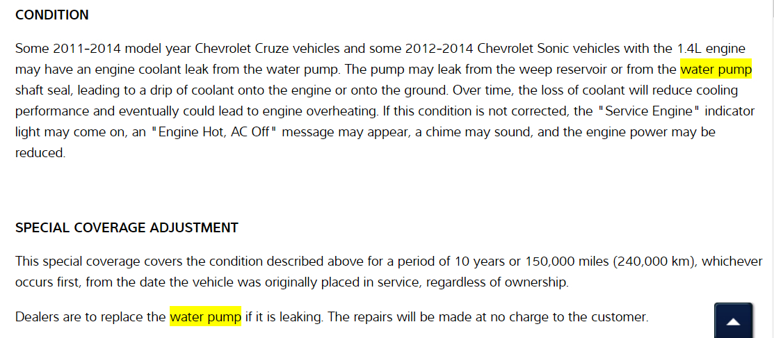

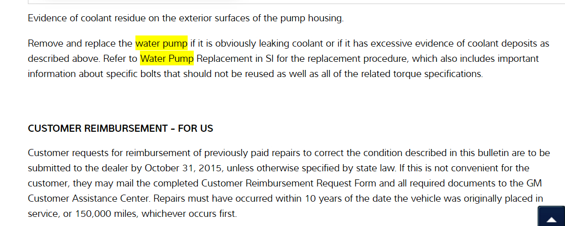

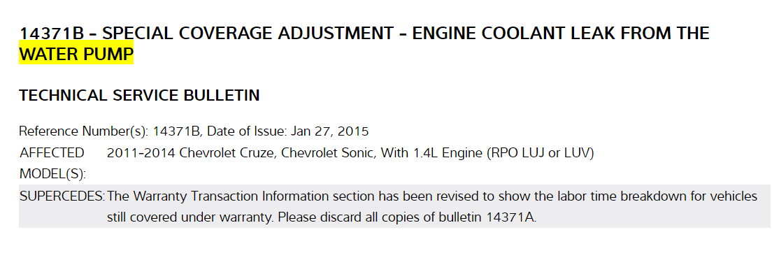

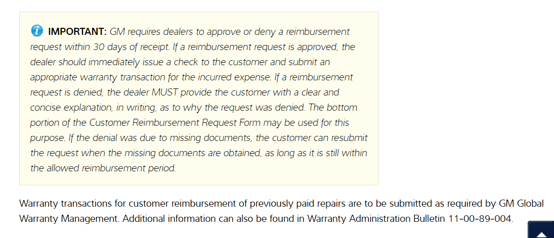

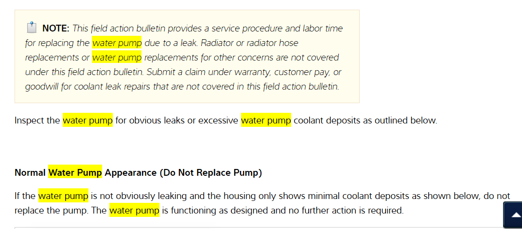

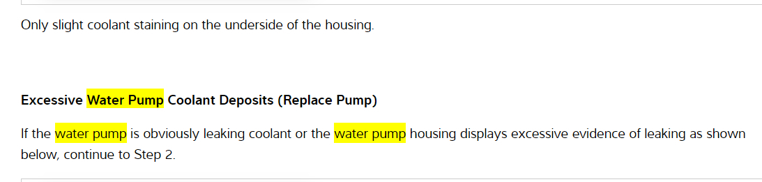

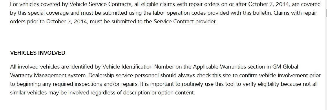

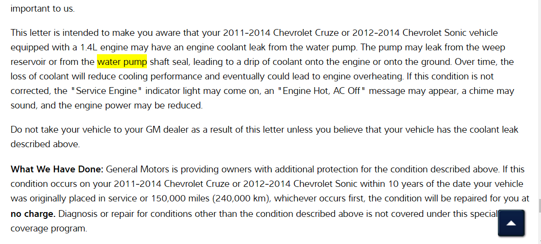

I hope that you have a 1.4L engine because as I was doing research on your vehicle I came across this Technical Service Bulletin (TSB) for a recall on your vehicle's water pump. You probably want to call your local dealership and inquire about having it replaced free of charge, I have included the TSB in the diagrams down below.
Thanks,
Alex

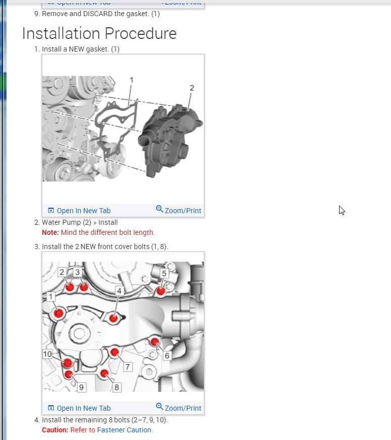

I bought an OEM metal, pre-coated gasket. Is there a wait time before I can refill the coolant? And is any other sealant necessary?
Sep 21, 2020 at 3:48 AM (Merged)
I attached the instructions for this but the short answer is no. You do not need to wait nor do you need any sealant.
Let us know if you need more info. Thanks
