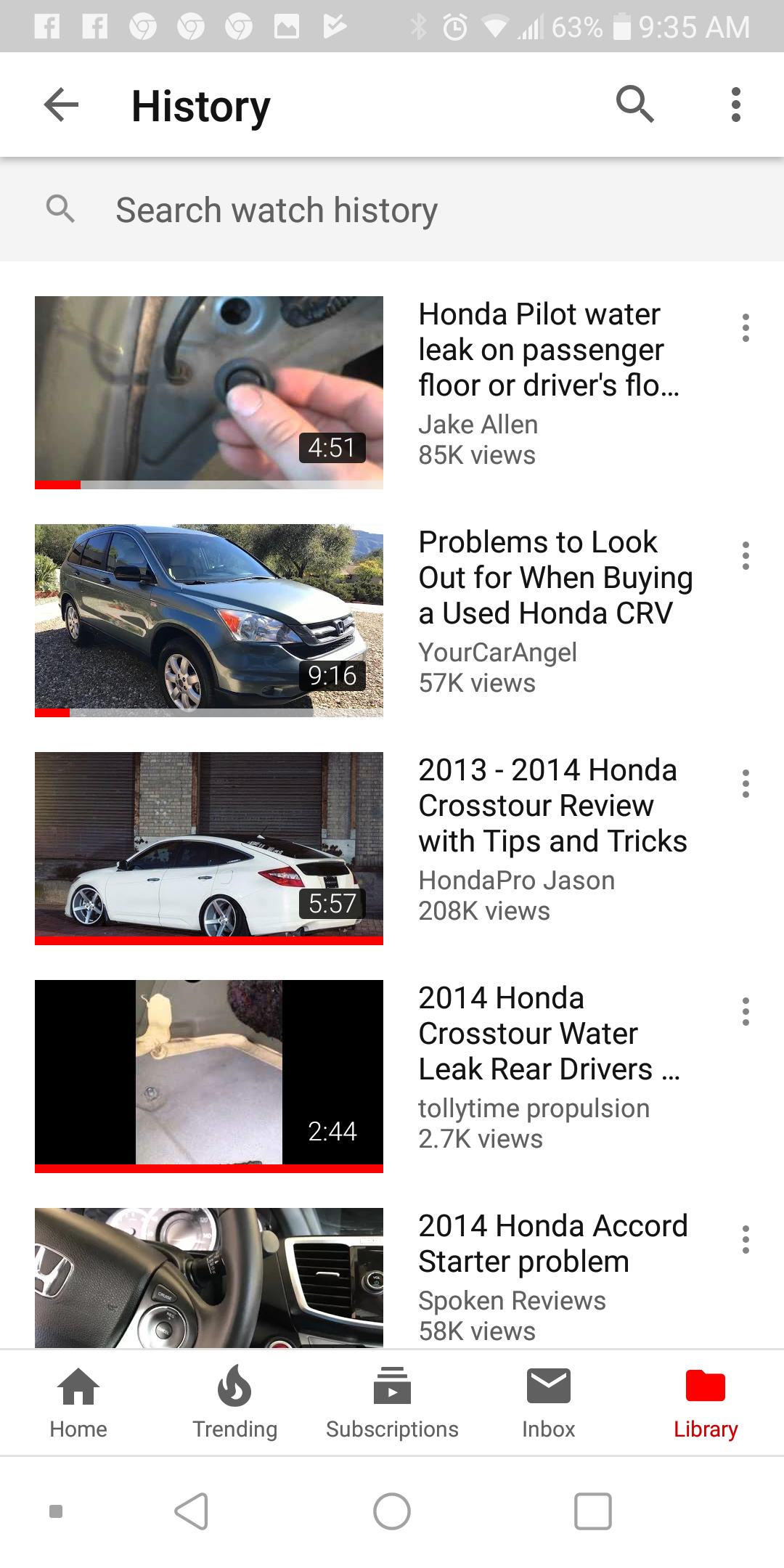

I just bought the vehicle listed above used. I have had it since Jan 11 2019. If l have come across a really bad issue will Honda help me fix it even though it is over the 30 day mark. I have only put 2,000 miles on it, because i had another car to drive to and from work. I have a warranty but this issue is not covered. Wish l had taken it to a shop to get checked over before i bought it. but l had trust in the person that sold it to me telling me l got a great deal. I bought it from. a Honda dealership.

I m pretty sure it Is from the road getting up through the bottom of my car. I saw a video and what it was going on with another Honda pilot. It is on YouTube.

You need to include some information. I don't know what you're referring to. Road salt? Hurricane flooding? Why do you think it should covered under warranty? What problem is it causing?

Can you post a photo of the problem? If you're going to reference a video, you need to include the link to it.

Well heres proof n to pay 16000.00 plus tax plus extended warrnty , is so not fair to find this out 2000.00 kms later....BS

I don't need proof of what you're complaining about. I need to know what you're complaining about. I went out and researched this since you refuse to explain what the problem is. There are a number of different things people are complaining about related to water, and numerous fixes, which suggests there is not a manufacturing defect or recurring problem. One person found salt stains inside after driving through deep water. A plastic plug was missing in the passenger floor area. Two people found water running in around the tail light housings but they couldn't tell if a seal was leaking or if it was due to the design. Another one was solved when the dealer replaced the rubber weatherstrip around the hatch opening. They did that under warranty. Multiple people were wondering if water was simply dripping from the hatch when it was opened.

To get back to your problem, the first thing you need to do is state the exact problem. You're either seeing water, rust, stains, or all of those. If there's rust or stains but nothing is wet, those could be from a previous problem that has been repaired.
If there's water getting inside, you're the expert who is going to diagnose that, then we can make an informed decision on whether it is up to someone else to pay to fix it. For some hints to get started, look at how high up you see a stain, and if that runs all the way around the passenger compartment. That will tell us if it was due to trapped standing water, as in a flooded vehicle, or if water is running in one area up high, and running straight down. If you see droplets up high, especially on or above windows, and it's spread out over a large area, that's from condensation. I get that often in my minivan. To solve it, I just leave one window rolled down 1/4" in humid weather.
If you find evidence of water in the rear, I prefer to remove the trim panels, and dry the area, then I crawl inside and have a helper spray water up high, so it rains down in a normal fashion. If water is directed upward with a hard stream from a garden hose, water can be expected to infiltrate through vents and exhauster ports. Watch with a flashlight to see if water is sneaking in around weather seals, light housings, antenna bases, and things like that. If you see leakage around a weatherstrip, dry it, then spray the door lightly with leak-tracing powder. Close the hatch or door gently, open it, then check for places where the powder did not transfer to the weather seal. If the seal is deformed in one spot, such as when an antenna cable was run over it, you might get it straightened out by heating it a little with a hot-air gun. Another trick is to cut a slit on the side of it, then stick in a piece of vacuum hose or washer hose. If a longer section isn't sitting up high enough, you can pop the seal off, stick a piece of washer hose into the groove, then slide it back on. The hose will hold the seal up closer to the door panel. Related to this, check the adjustment of the door. Specifically, look for an edge that sits "proud" of the adjacent panel. Adjusting the hinges or the latch will close the door tighter against the seal. We use a "special tool" when testing how well a weatherstrip seals. That is a dollar bill. Close the door with the dollar draped over the seal. You're looking for any place where you can slide the dollar sideways or in and out freely. That area needs more pressure on the seal.
