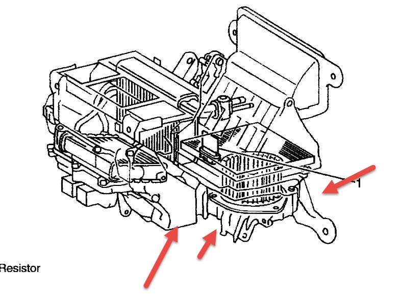

I have water to accumulate in the passenger side front floorboard after a heavy rain. I do have a sunroof but, I have checked the drains and cleared those (had that problem last year). I'm not sure where the water is coming in from since the area that I was getting the water into the car from the sunroof drain issue is bone dry. If it's not raining outside, it dries up after a couple of days with me sopping the water up with a shop vac and towels. The water is not discolored and doesn't smell like anti-freeze. Any ideas on how to fix this would be greatly appreciated.

your heater drain may be plugged. we dont' have a good pic of that so check under the car in the area's I've pointed to it may even be off of firewall. use like a piece of caot hanger you won't hit anything.
