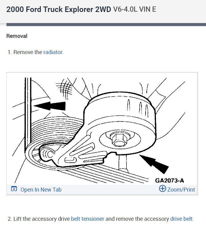

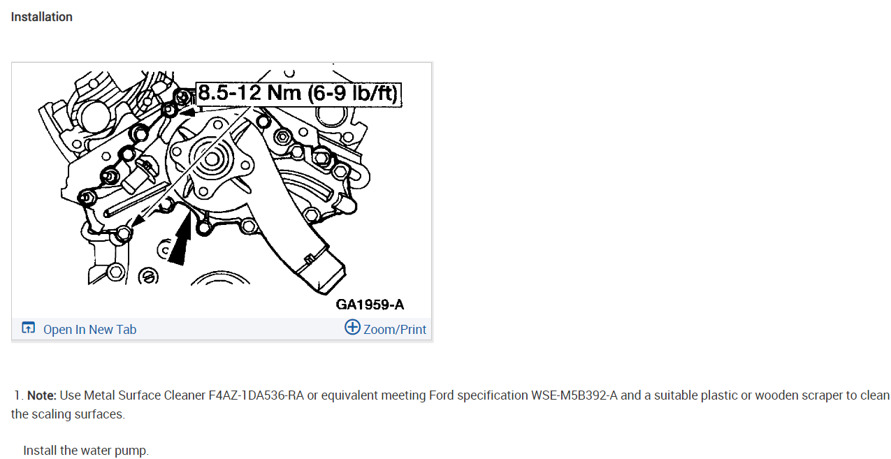

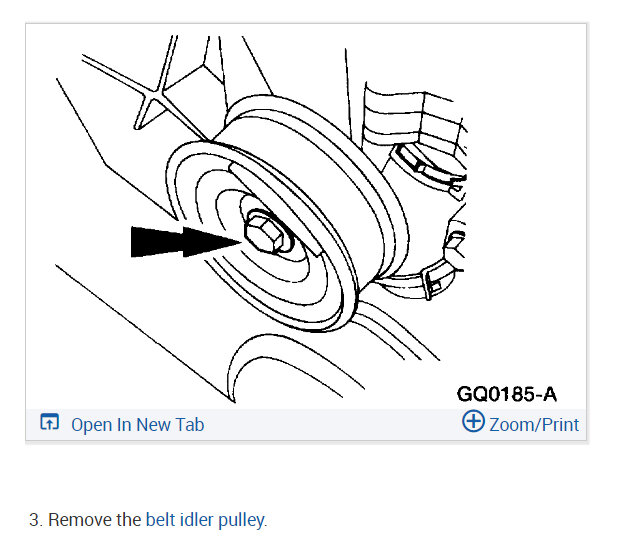

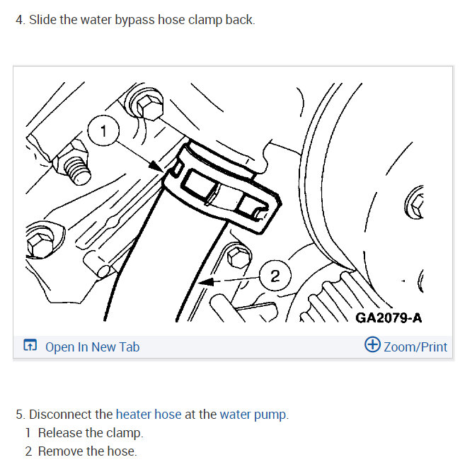

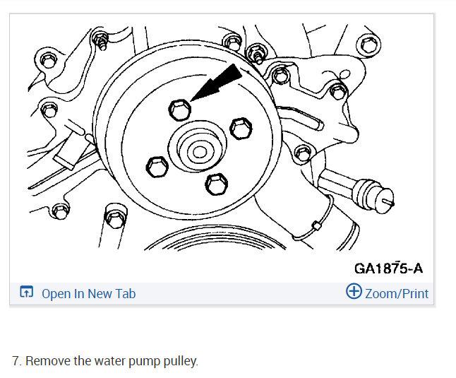

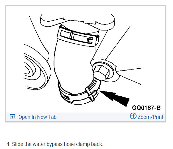

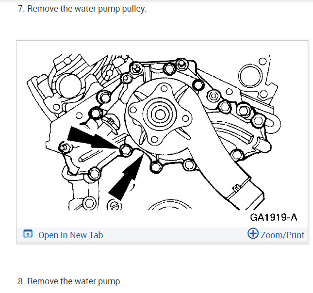

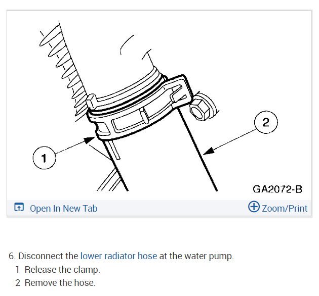

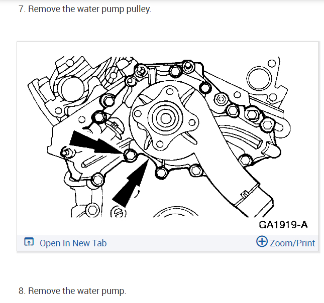

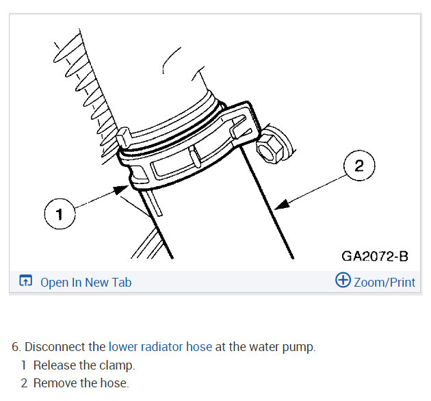

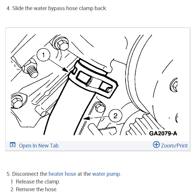

Yep, front middle of the engine sounds like a water pump but to be sure let's use these guides to confirm the issue. I would raise the car in the front and use a flashlight to help.
and
https://www.2carpros.com/articles/car-is-leaking-coolant
Here is how to change the water pump out in case you need it. Can I ask why you don't respond to any of your posts? Here is a generic guide to help you step by step with instructions in the diagrams below to show you how to on your car.
https://www.2carpros.com/articles/water-pump-replacement
