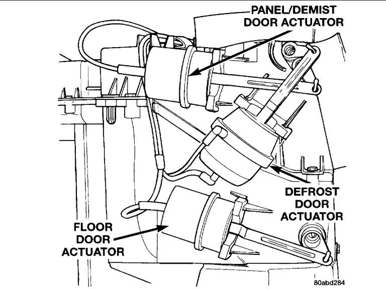

Like I said, it will only blow air our through the defroster setting. If I switch it to A/C setting, nothing comes out. I think my son put a different settings panel in there last summer, but it didn't help.
Monday, July 22nd, 2019 AT 1:07 PM
  • 52,797 POSTS
A/C in your original post you said the A/C does not work.
If you have defrost only, that could be an actuator but has nothing to do with the water leak.
I attached a picture of the defroster motor. Check for any vacuum to the motor with the command at the vents.

The A/C doesn't work; only getting air from outside when I turn on defroster. No cool air.
