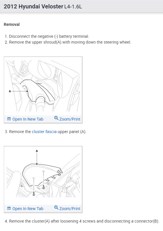

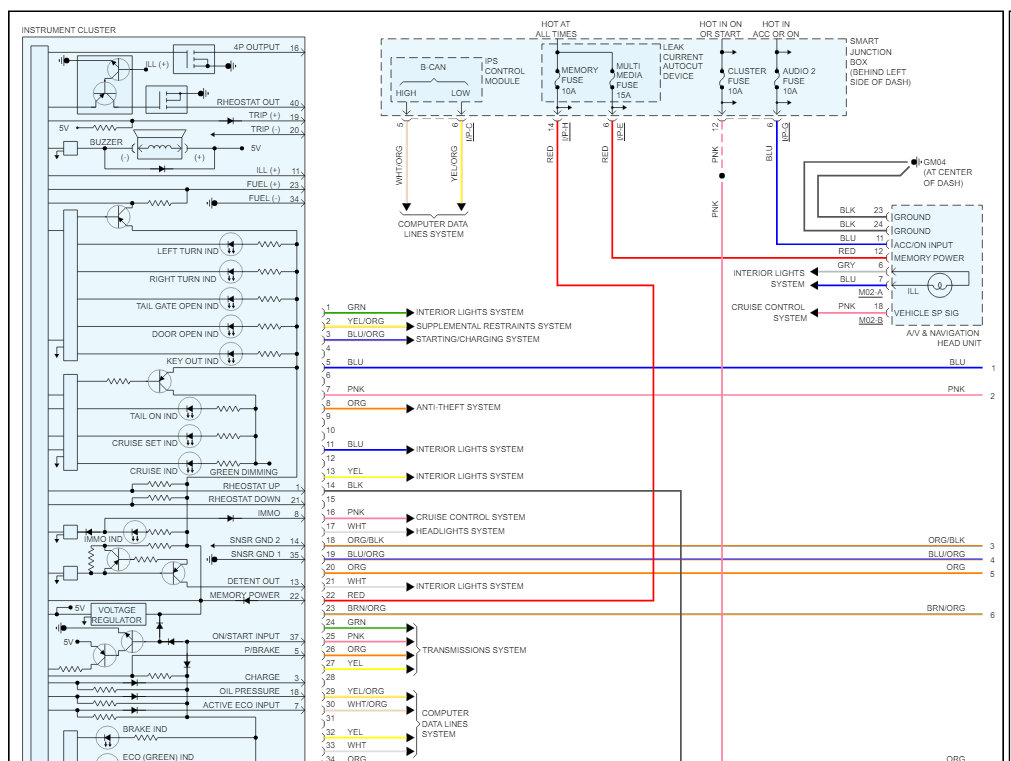

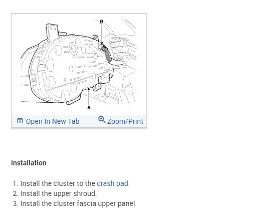

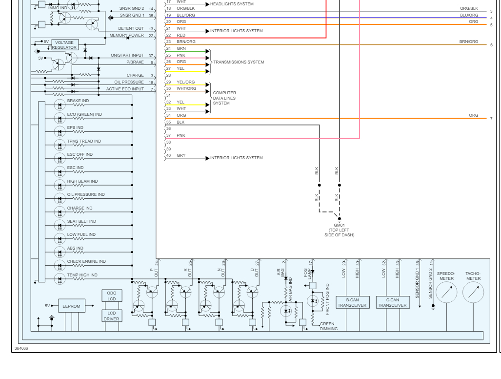

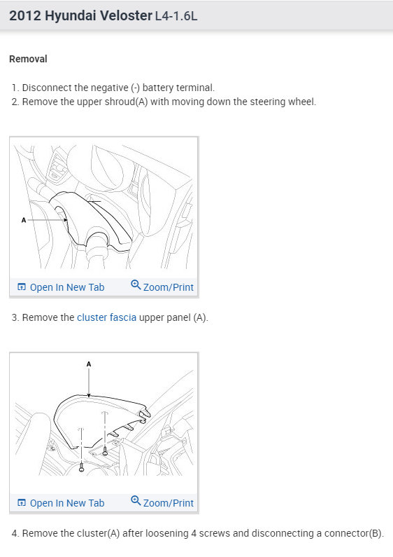

Just to clarify when you turn on the key none of the warning/message lights illuminates?
If that is what you are experiencing, it is likely due to a faulty gauge cluster.
This will either require replacement or rebuild the electrical components for the cluster.
If it is just one or two lights, then it could be due to a bad LED or wiring issue.
I have attached the wiring schematics for the gauge cluster below for your reference.
Let me know of any questions.

I have to say regarding the warning dash lights I tried the first thing, least costly was to change the 10amp fuse and that did the trick. I appreciate the help and reply.
