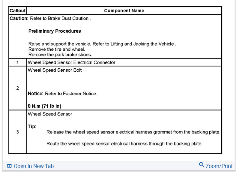

Hi, I have just had new coil pack fitted and spark plugs. also c.v legs to both sides front. now my ABS light has come on plus car with spanner through it. what could be wrong with it now? please had a code reader on it but no faults come up/
Feb 27, 2019 at 8:30 PM
  • 55,097 POSTS

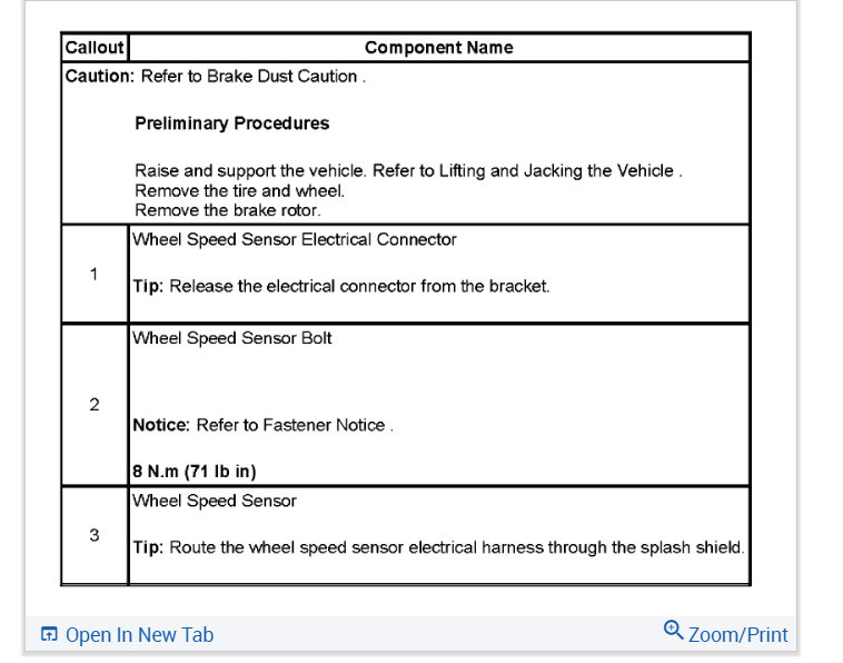

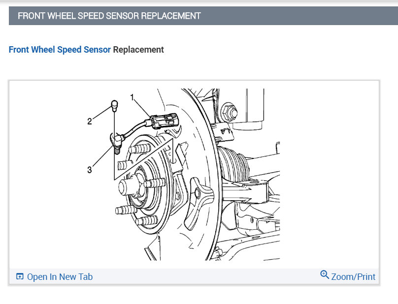

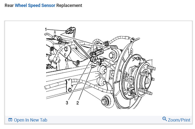

Nine times out of ten it is a wheel speeds sensor that has failed. Here is a video to tell you how to find out which one or you can use the guide below to test the sensors manually.:
https://youtu.be/rTtAnsOlZU4
and
https://www.2carpros.com/articles/abs-wheel-speed-sensor-test
Check out the diagrams (below). Please let us know what you find.
