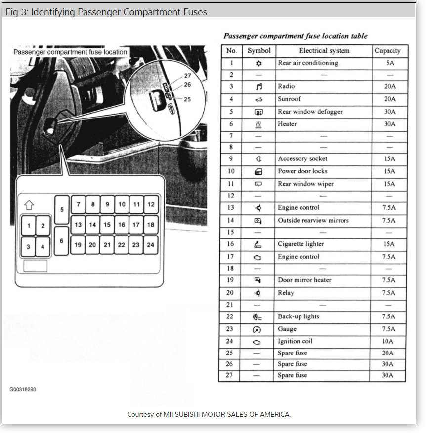

The door lock and interior light problem seems like a fuse #10 15 amp can you check it?

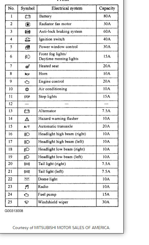

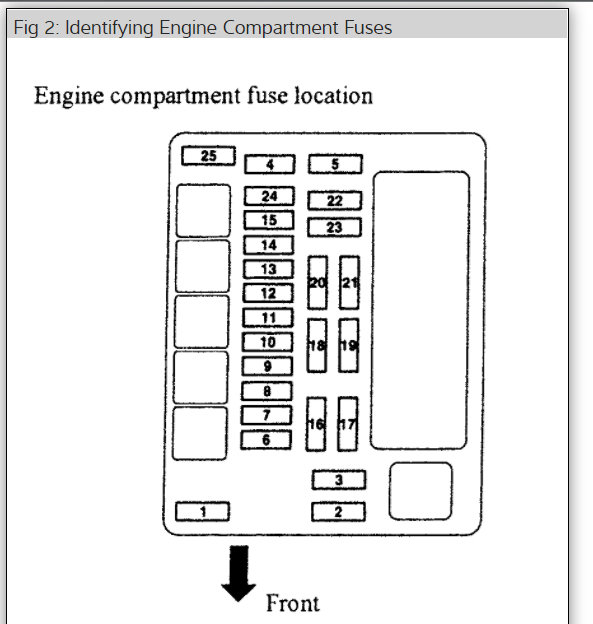

Ken, I had the starter replaced and that was a good idea thank you! Though I still have a problem with no turn signal or hazzard lights working. Do you know which relay controls them. Mechanic said all fuses were working fine but from your images I wasnt sure which exact fuses and relay we should check or try to replace.
