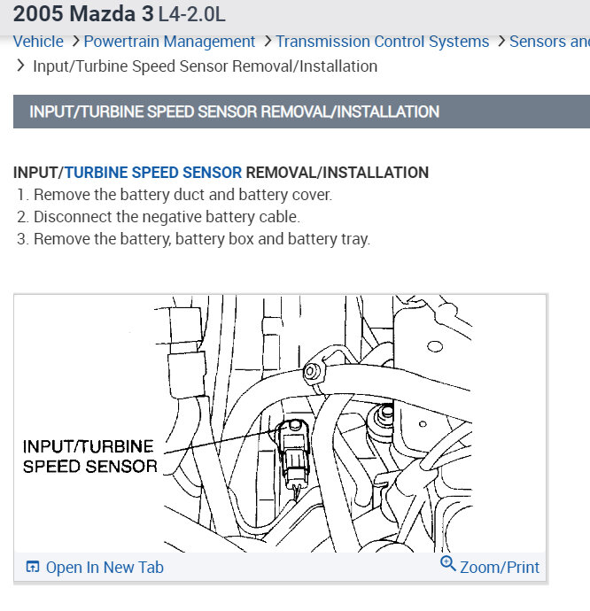

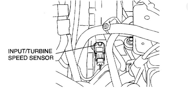

Need to know the location of the input speed sensor on the transmission.

They call it a turbine shaft speed sensor. Check out the images (Below). Please let us know if you need anything else to get the problem fixed.

Input sensor on a transmission, transmission won't shift into high gear.

Again, do you have a code?
If the input speed sensor was the issue it would not shift as that signal is critical for shifting. The location is in the diagrams below.

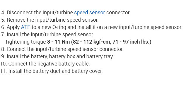

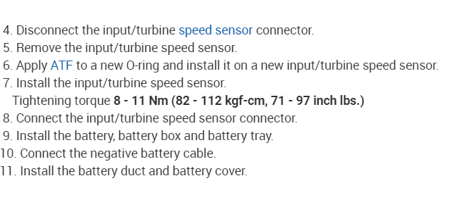

NPUT/TURBINE SPEED SENSOR REMOVAL/INSTALLATION
1. Remove the battery duct and battery cover.
2. Disconnect the negative battery cable.
3. Remove the battery, battery box and battery tray.
4. Disconnect the input/turbine speed sensor connector.
5. Remove the input/turbine speed sensor.
6. Apply ATF to a new O-ring and install it on a new input/turbine speed sensor.
7. Install the input/turbine speed sensor.
Tightening torque 8 - 11 Nm (82 - 112 kgf-cm, 71 - 97 inch lbs.)
8. Connect the input/turbine speed sensor connector.
9. Install the battery, battery box and battery tray.
10. Connect the negative battery cable.
11. Install the battery duct and battery cover.
