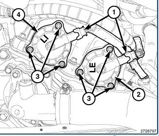

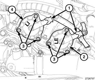

Here are the directions for removal and replacement:

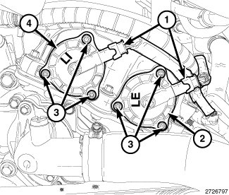

VARIABLE VALVE TIMING SOLENOID - REMOVAL
LEFT
pic 1
Disconnect and isolate the negative battery cable. If equipped with an Intelligent Battery Sensor (IBS), disconnect the IBS connector first before disconnecting the negative battery cable.
NOTE:
Mark the variable valve timing solenoid connectors (1) with a paint pen or equivalent so that they may be reinstalled in their original locations.
Mark the intake variable valve timing solenoid (4) and the exhaust variable valve timing solenoid (2) with a paint pen or equivalent so that they may be reinstalled in their original locations.
Disconnect the electrical connector (1) from the variable valve timing solenoid.
Remove the variable valve timing solenoid mounting bolts (3).
pic 2
Pull the variable valve timing solenoid from the cylinder head cover.
The seal (1) can be reused if not damaged.

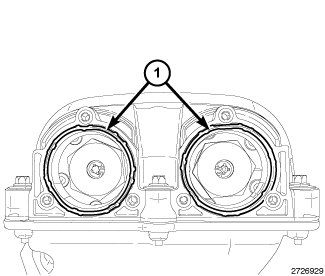

Install
LEFT
pic 3
Install the variable valve timing solenoid seals (1). The seals can be reused if not damaged.
pic 4
Refer to the markings made at disassembly and install the intake variable valve timing solenoid (4) and the exhaust variable valve timing solenoid (2) in their original locations.
Install the variable valve timing solenoid mounting bolts (3) and hand tighten.
Connect the electrical connector (1) to the variable valve timing solenoid.

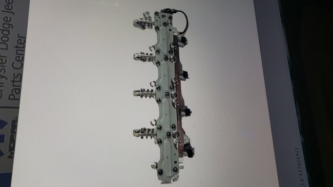

It shouldn't look like this? I got obd2 code P1066.

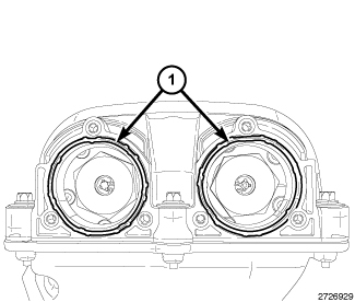

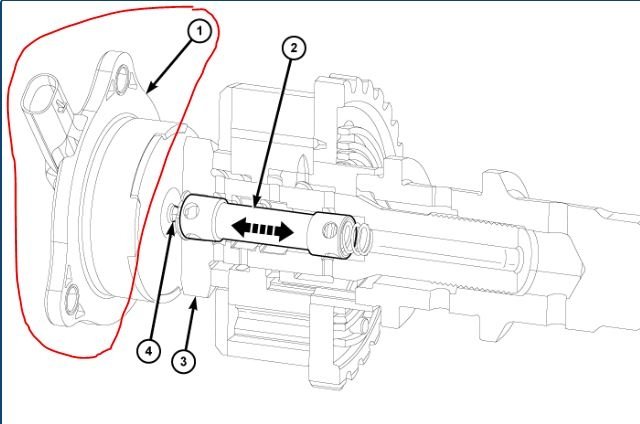

Take a look picture 1. Number 1 in the pic is the VVT solenoid. Picture 2 shows the solenoid (circled), number 2 is the spool valve, number 3 is the oil control valve, and number 4 is the solenoid pintle.
Can you take a picture and upload where you are working on the car, so I know exactly what we are dealing with? I will also tell you that the code is most often caused by low oil, dirty oil, or a plugged screen.

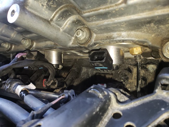

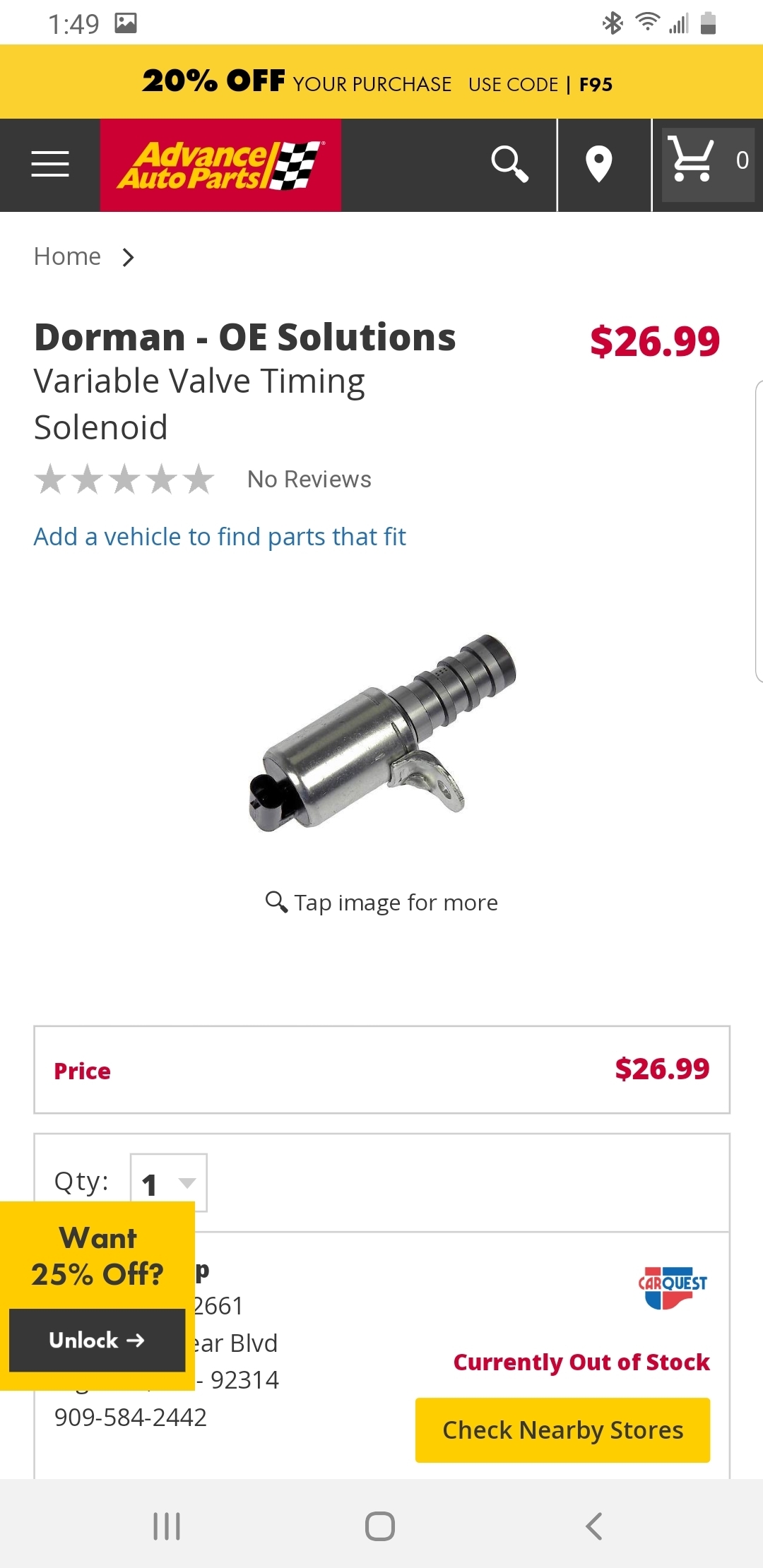

I was driving when I heard what sounded like a slight knock, when I went to pull over the check engine light came on. Got code P1066, site for scanner said (cylinder 1 oil supply solenoid valve switches off time out of range). Thought it was solenoid on the VVT actuator (picture) (firewall side of engine, next to fuel rail). Picture 2 is from that side of engine I found online. But if your right I need that solenoid in your picture? Your help is so appreciated.

I'm sorry to hear that. I need to go back to the beginning. You sent a picture of a VVT solenoid which is different than what I sent you. Are you sure that part is for your car? As far as replacing the solenoid, the directions I originally provided are specific to your vehicle. Once the VVT cover bolts are removed, then you can replace the sensor.

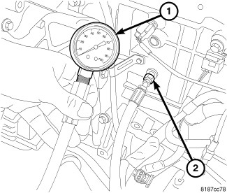

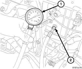

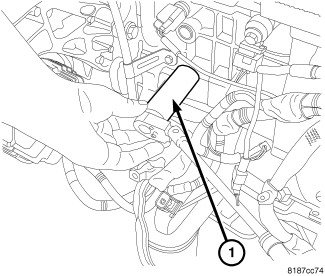

CHECKING VVT OIL PRESSURE
This test can be used to help diagnose VVT faults.
pic 1
Disconnect and remove oil pressure sensor (1).
pic 2
CAUTION:
Threads in block are 1/8”-28 British Standard Pipe (BSP). Do not install a National Pipe Thread (NPT) threaded adapter, this could crack the cylinder block.
Install an 1/8-28 BSP male to 1/8-27 female threaded adapter (2).
Install oil pressure gauge (1).
Start engine and record oil pressure.
CAUTION:
If oil pressure is 0 at idle, do not perform the 3000 RPM test
If oil pressure is 0 at idle, shut off engine. Check for pressure relief valve stuck open or a clogged oil pick-up screen.
Remove oil pan and inspect for debris (Refer to 09 - Engine/Lubrication/PAN, Oil - Removal) .
Remove oil pressure relief valve (Refer to 09 - Engine/Lubrication/VALVE, Oil Pressure Relief - Removal) and inspect, if damaged replace pressure relief valve.
If pressure relief valve is ok, replace balance shaft module assembly (Refer to 09 - Engine/Lubrication/Pump, Engine Oil - Removal).
pic 3
After test is complete, remove test gauge (1) and fitting (2).
pic 4
Install oil pressure sensor and electrical connector.
____________________________________
If you do this, let me know the results.

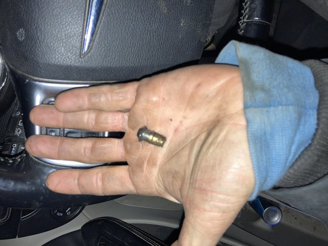

JOSH WILLIAMSON
Hello, I found this thread very informative thank you for the pictures it’s been so hard to find some description. The guys at AutoZone had no idea what the VVT solenoid was. I was changing Mine for a 2012 Town and Country p0020 code, and when I unscrewed the last bolt, the cylinder that it goes into, came out of the actuator and I can’t get them apart for the life of me.
Am I able to order this?
Nov 13, 2021 at 8:37 AM
  • 110,240 POSTS
Hi, Josh.
What exactly am I looking at in the pic? As far as the solenoid, when you removed the three bolts, were you able to remove the solenoid? If so, did part of the phaser come with it?
If that is the case, the phasers are not serviceable. They are replaced as a unit. I'm trying to picture what you can't get apart.
Let me know. Hang in there. We'll get it figured out.
