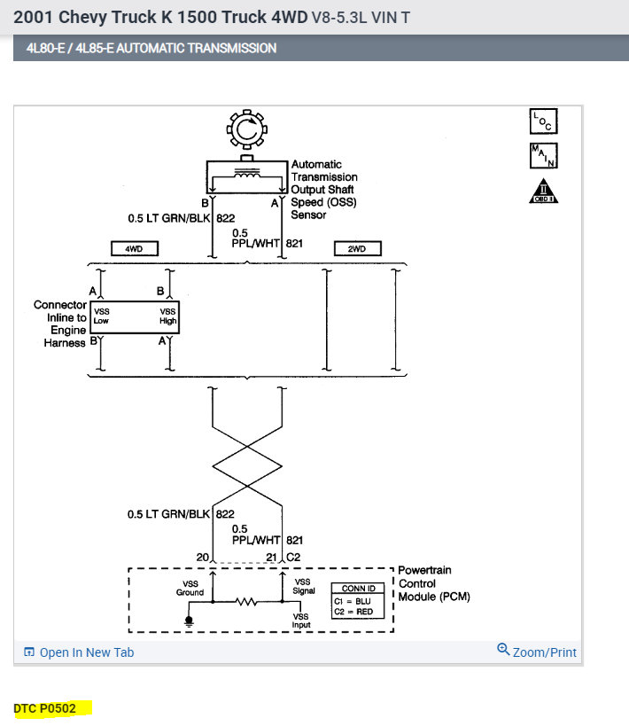

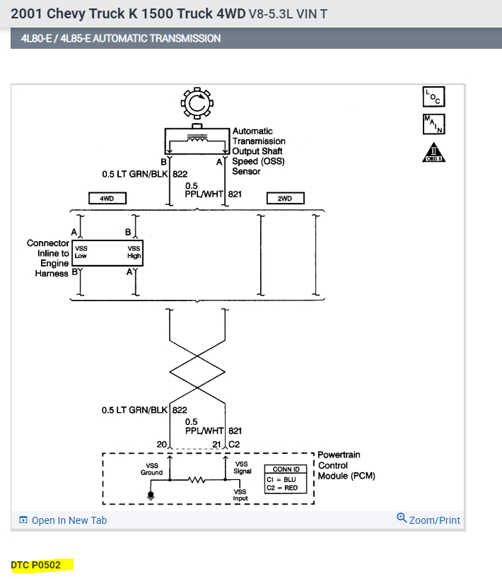

The VSS isn't working, the speedometer doesn't work but we have odometer etc. We replaced the VSS plugs but we still get the P0502 code (VSS Circuit low input) I would like to know how to replace the wires (or check if they are open/closed circuits) in a the truck listed above.
