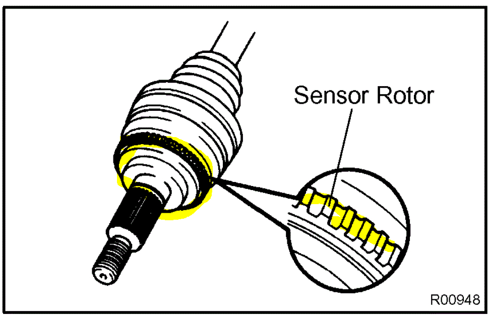

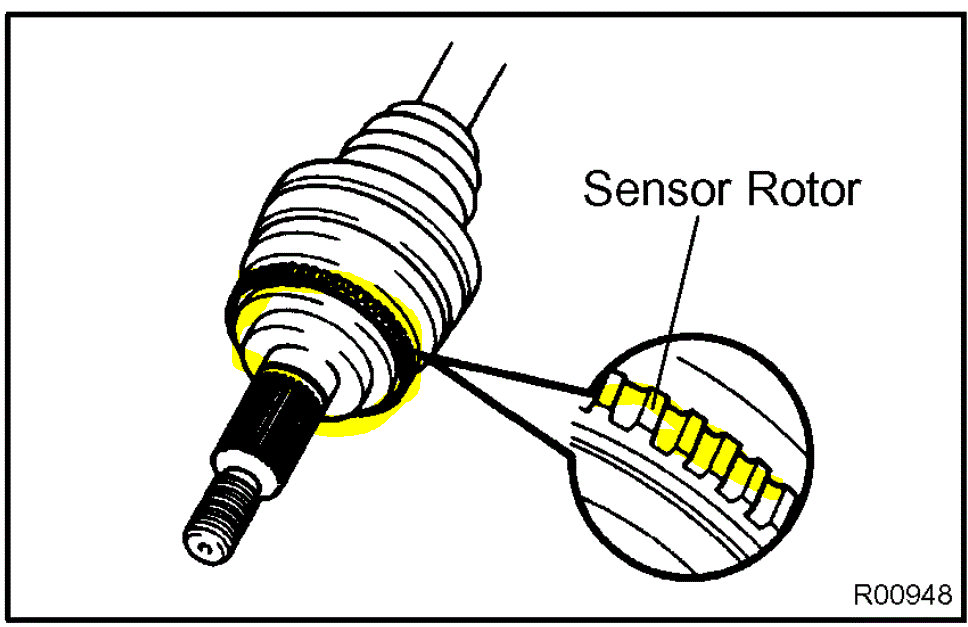

Let me know if the light goes out for the VSC. I'm interested in knowing. Also, you mentioned rust. Make sure the toner ring (sensor rotor) isn't rusted, loose, damaged, or dirty.

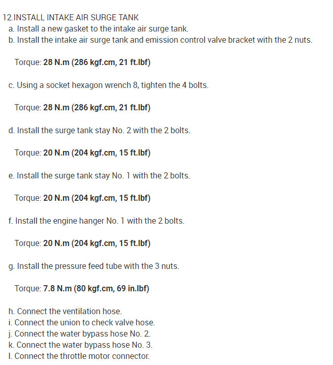

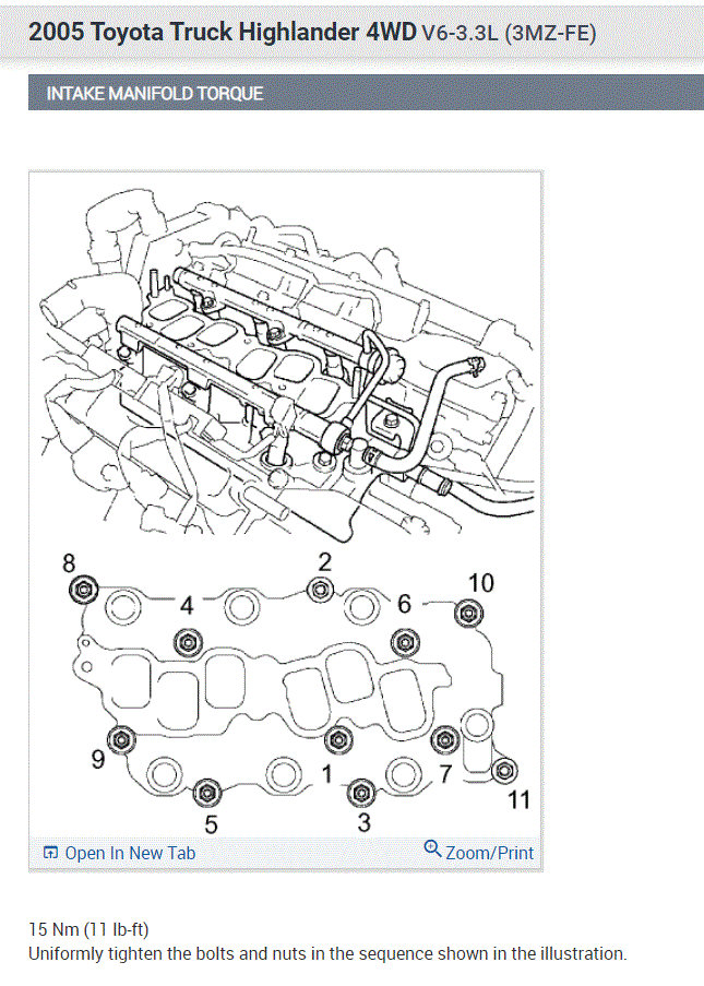

I removed the upper intake manifold plenum to get access to the spark plugs on my 2005 Toyota Highlander . Can you tell me the torque for the Allen head bolts that I removed? Where can I find torque setting for this car?

Absolutely, we can help. If you look at the pic below, it includes the torque specs. Additionally, it shows the torque sequence (order to tighten them). Make sure to follow the sequence provided.
See pic below.

Thank you for the intake manifold torque information. Would those torque settings also be good for the air plenum that bolts to the intake ? I’m now going to change the timing belt, water pump, front cam seals, pulleys and belts. Two questions; the kit I ordered came with a paper water pump gasket would you recommend getting a metal type? Also the timing belt does not have marks for lining up the timing marks. Can I transfer the marks from the old belt to the new belt or count ribs between the old marks ? Thanks again.

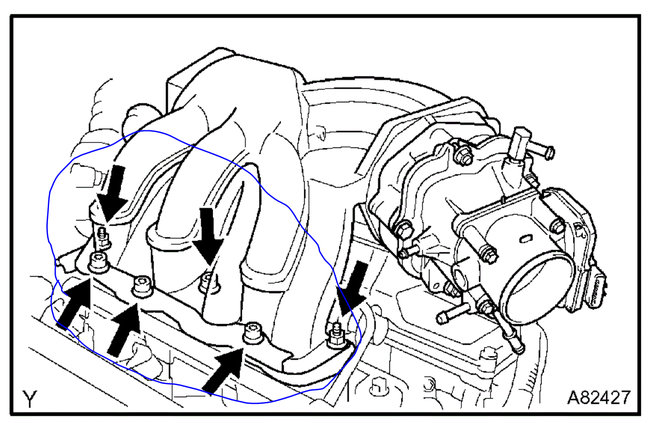

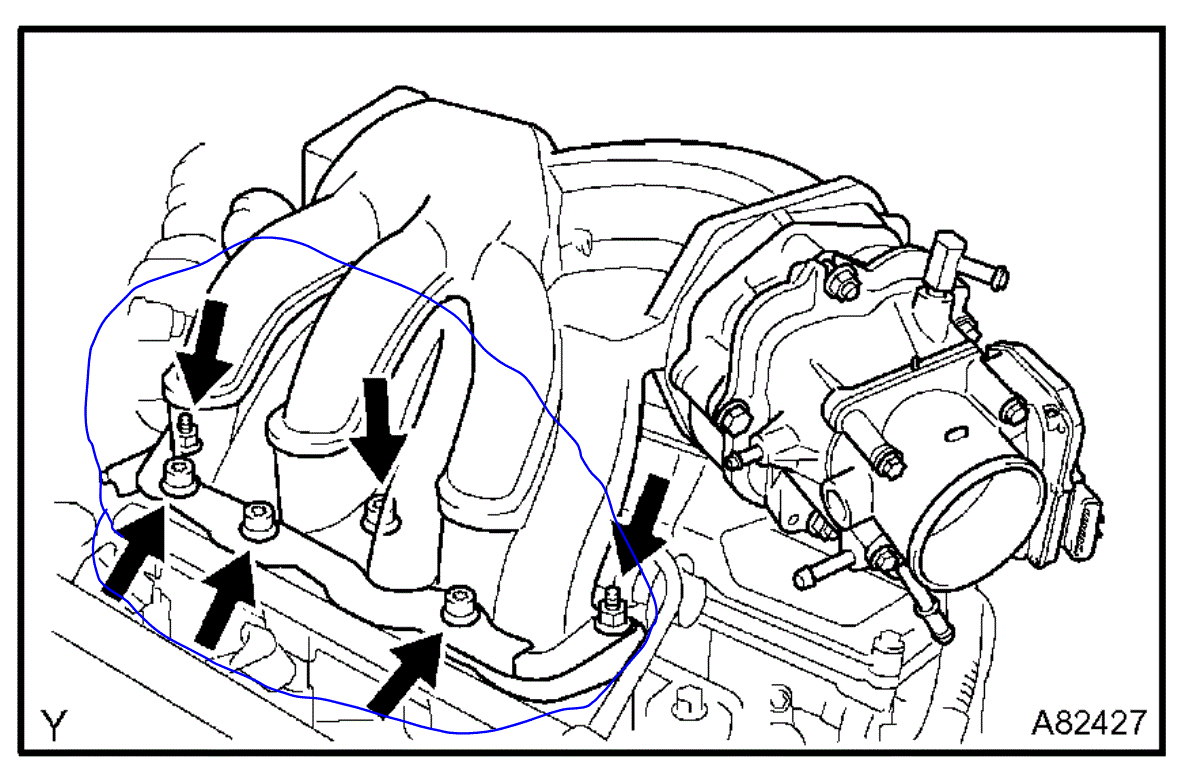

I believe you are referring to the intake surge tank (upper intake). Take a look at pic1 below. If that is what you are referring to, the directions and specs are in pic two for replacement. If that isn't it, let me know.
