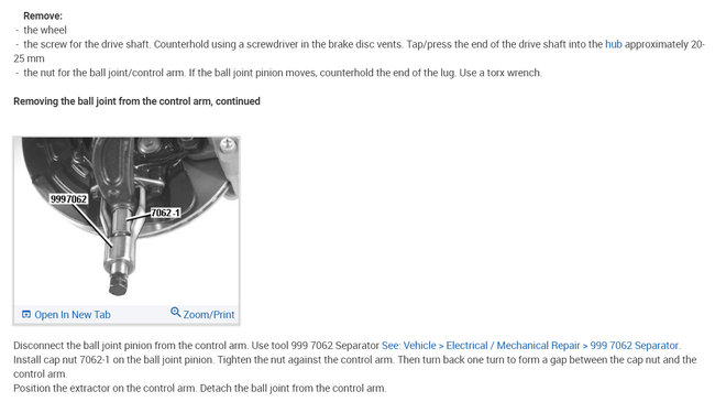

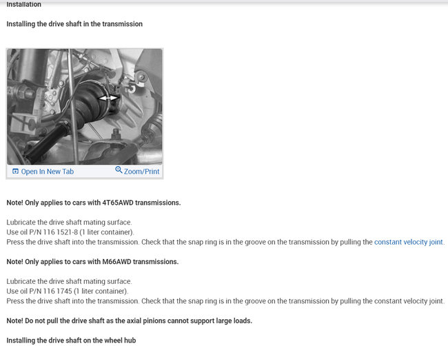

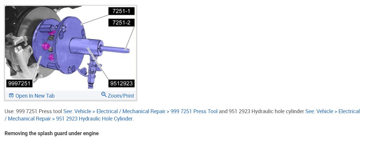

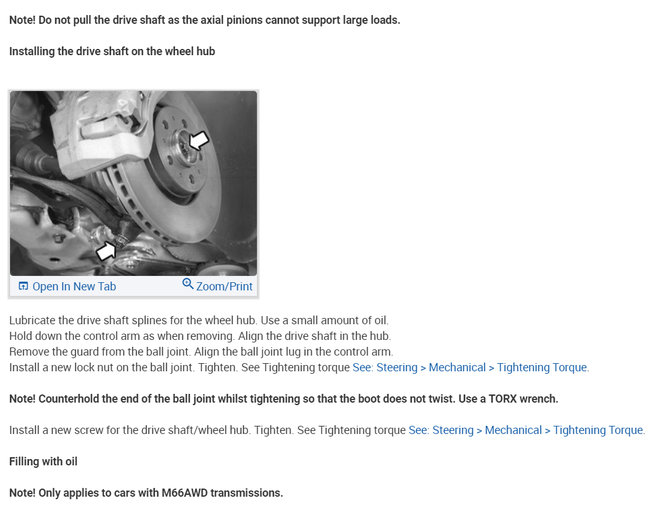

  • 55,325 POSTS

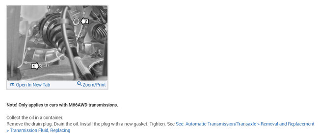

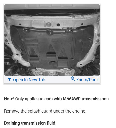

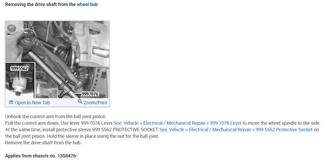

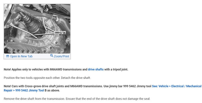

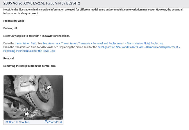

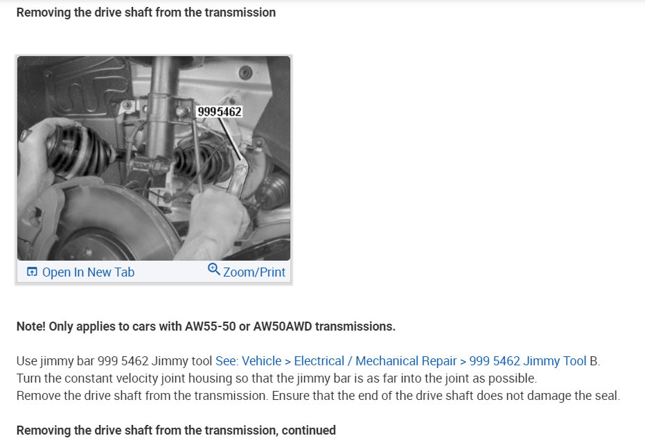

Yes it does what happens is the CV joints bind due to wear which causes the vibration. here is how you fix it. I would do both axles here is a video of the job being done on a similar car with instructions in the diagrams below on how to fix you car.
https://youtu.be/Cm3ZCw0_MLo
