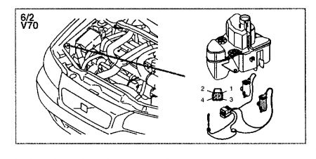

how involved is replacing the washer pump in my volvo wagon?
Nov 13, 2008 at 5:33 PM
DAVE H
✓ASE Certified Mechanic
13,384 POSTS
unclip the wiring plug ...pull the pump out of the bottle it's held in by a rubber seal .. clean filter on pump or replace with new pump .. push back into bottle ..clip wires back together and test ..
