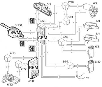

With the wiper switch in the "OFF" position, the windshield wipers run continuously (just slightly more slowly than in the "LOW" position). The problem is a bit intermittent - sometimes will work correctly for a day, then back to running all the time.
I replaced the wiper switch. Worked ok for 2 days, then back to running continuously.
Checked the ground connection for the wiper motor electrical connection - voltmeter said it was ok; cleaned ground lug where it bolts to chassis (voltmeter still says ok); wipers still run continuously.
Have seen similar symptoms in other manufacturer cars online as being due to bad park switch in the wiper motor. Not sure if this is applies to this car (2002 Volvo V70 X/C). In intermittent mode, the wipers do stop at the correct position.
Any help would be appreciated. I'd prefer to not replace wiper motor unnecessarily...

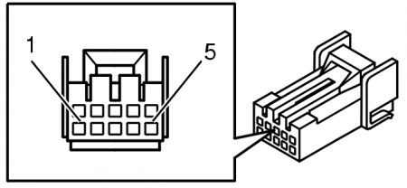

Hello .. thanks for the donation .. much appreciated Check the rain sensor is giving the correct voltages !
https://images.2carpros.com/forum/automotive_pictures/266999_vol_4.jpg
https://images.2carpros.com/forum/automotive_pictures/266999_vol2_1.jpg

Jul 27, 2010 at 2:01 AM
DAVE H
  • 13,384 POSTS
Information about the position of the control stalk is transmitted to the central electronic module (CEM) on the controller area network (CAN). The central electronic module (CEM) also receives a signal from the wiper motor if the wipers are in the park position.
The central electronic module (CEM) also monitors the windshield washer reservoir level via a level sensor in the reservoir. The switch in the level sensor closes if the level falls below one liter. A text message indicating that the windshield washer fluid needs to be topped up then lights in the driver information module (DIM).
The power supply for the rear windshield wiper is via a directly connected relay on the rear electronic module (REM). Other wipers and the washer motors are supplied with power via relays in the engine compartment.

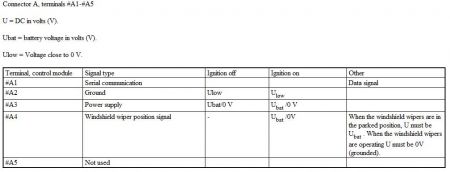

Jul 28, 2010 at 5:21 AM
DAVE H
  • 13,384 POSTS
Wiper/washers for the windshield and headlamps The right-hand control stalk is moved downwards through three positions to operate the windshield wipers. The steering wheel module (SWM) (3/130) transmits information via the control area network (CAN) to the central electronic module (CEM) (4/56) about the selected position. The central electronic module (CEM) then activates relay 2/91 which supplies the wiper motor (6/1) with power in position 1. If high speed wiping is selected, relay 2/90 is also activated to power the motor in position 2. The central electronic module (CEM) receives a signal from the motor when the wipers are in the parked position so that the wipers can be stopped in the correct position. For intermittent wiping, the process is the same as for low speed, but the time between each stroke is set using the ring on the control stalk to one of eight positions between 1 and 27 seconds. The central electronic module (CEM) controls this once it has received information about intermittent wiping from the steering wheel module (SWM) via the control area network (CAN). The windshield and headlamps are washed when the right-hand control stalk is moved towards the steering wheel. The steering wheel module (SWM) transmits information to the central electronic module (CEM) via the Control area network (CAN) to activate washing. The central electronic module (CEM) activates the relay 2/92 which powers the pump motor (6/2) and wiper motors (6/3-4) for the headlamps. The central electronic module (CEM) receives a signal from the level sensor (7/5) in the windshield washer reservoir so that it can check the windshield washer reservoir level. The switch in the level sensor closes if the level falls below one liter. The central electronic module (CEM) sends the signal to Driver information module (DIM) (5/1) via the controller area network (CAN). The driver information module (DIM) displays a text message indicating that the windshield washer fluid needs to be topped up. The tailgate wiper (6/32) (V70/V70XC) is controlled by the rear electronic module (REM) (4/58). The rear electronic module (REM) receives a control area network (CAN) signal from the steering wheel module (SWM) via the central electronic module (CEM). The rear electronic module (REM) then powers relay 2/16 to start the tailgate wiper. The tailgate wiper is powered via relay 2/72. The tailgate wiper can be programmed so that it is activated if the windshield wipers are on and back-up gear is selected. Rear windshield cleaning is activated when the right-hand control stalk is pushed away from the steering wheel. The steering wheel module (SWM) sends signals via the control area network (CAN) to the central electronic module (CEM) to activate rear windshield washing. The central electronic module (CEM) activates relay 2/93 to power the pump motor (6/30). At the same time the rear electronic module (REM) activates the tailgate wiper. The wipers only operate at low speed if there is a fault in the control area network (CAN). If this is the case, the central electronic module (CEM) receives a directly connected signal from the steering wheel module (SWM). There is no Limp Home function for the rear windshield washer and wiper.
https://images.2carpros.com/forum/automotive_pictures/266999_vol_5.jpg
