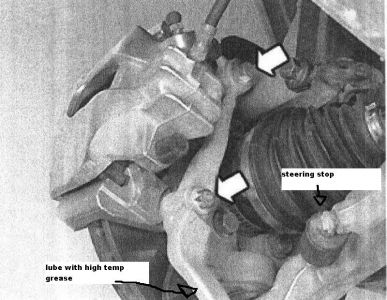

I had a problem develop recently where my car makes a terrible shuddering sound when I make tight turns at low speeds. As a result I have had the driveshaft bearing, rear differential, and front axles replaced to no avail. My mechanic is still trying to figure out the problem, but so far I have not answer.

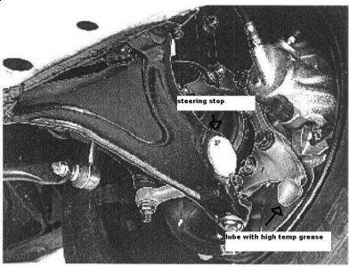

Check the control arm and make sure the steering stop has not broken off. If it has then you have metal on metal contact. Install new stop and lube. Attaching pics for you to view and hope this helps.
https://images.2carpros.com/forum/automotive_pictures/337695_steeringstop_1.jpg
https://images.2carpros.com/forum/automotive_pictures/337695_steeringstop2_2.jpg
Added 2 pics because it is going to look like one or the other?
