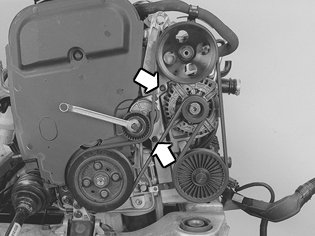

How do you change a serpetine belt. Do you have a diagram?
Sep 11, 2010 at 1:16 PM
  • 75,992 POSTS
Auxiliaries belt / belt tensioner, replacing Note! As the illustrations in this service information are used for different model years and / or models, some variation may occur. However, the essential information in the illustrations is always correct. Removing the auxiliaries belt
https://images.2carpros.com/forum/automotive_pictures/12900_d1_11.jpg
Use a wrench and turn clockwise as far as possible to relieve the load on the belt Remove the belt. Replacing the belt tensioner

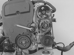

Use a wrench and turn the belt tensioner clockwise as far as possible. Install the belt in the following order: 1. Crankshaft 2. Generator (GEN) 3. A/C compressor. Idler pulley 4. Power steering pump 5. Belt tensioner. Wipe clean. Finishing Carry out a function test: Start the engine. Check the rotation of the belt and the function of the belt tensioner. Wipe the steering wheel and gear selector lever clean. https://www.2carpros.com/kpages/auto_repair_manuals_alldata.htm
