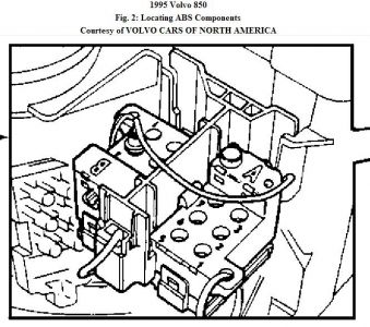

The ABS and TRACS lights have just come on while I was driving today. The SERVICE light goes out as normal. No other lights are lit.
Is there anything obvious that I can check or is the problem one that has to go to a garage?
I have access to lifting ramps and a reasonable knowledge of auto electrics.

Hi OPENDOOR, A fault has been detected in the ABS/TRAC system and you need to diagnbose and find out what is causing the problem.
https://images.2carpros.com/forum/automotive_pictures/192750_Diagnostic95Volvo850_1.jpg
1. Turn ignition switch on. 2. Plug cable into #3 hole in A block 3. Press button once. Count the number of LED flashes and write down the DTCs. Press button again and additional faults will be displayed.
