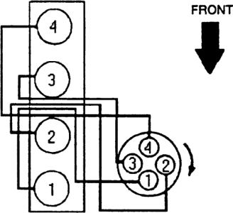

NEED FIRING ORDER FOR 1992 VOLVO 240 GL

Below is firing order for 2.3L 4 cylinder engines of the Volvo 240 series. Let me know if your engine size differs and I will post correct firing order for that engine. To avoid confusion, remove and tag the spark plug wires one at a time, for replacement. If a distributor is not keyed for installation with only one orientation, it could have been removed previously and rewired. The resultant wiring would hold the correct firing order, but could change the relative placement of the plug towers in relation to the engine. For this reason, it is imperative that you label all wires before disconnecting any of them. Also, before removal, compare the current wiring with the accompanying illustrations. If the current wiring does not match, make notes in your book to reflect how your engine is wired. 2.3L 4-Cylinder Engines Distributor Rotation: Clockwise
https://images.2carpros.com/forum/automotive_pictures/261618_0900c1528008c45d_1.jpg
