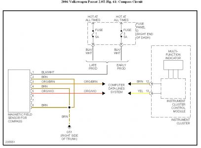

Apart on the activation procedures and the following schematic, our database does not have any information on the diagnosis of the fault.
https://www.2carpros.com/forum/automotive_pictures/192750_CompassCircuit06PassatGif61_1.jpg
Compass system is linked to computer datalines so appropriate scan tools might show you something.
Check the fuse if you had not done so yet.
Thursday, November 4th, 2010 AT 7:00 AM

Thanks, yes it might be one of those things the dealer might have to handle.
Regarding the fuse. This as well came to mind and when I went looking for the compass fuse as indicated in the owners manual, there was not a fuse in that slot (right dash board #3)
Thursday, November 4th, 2010 AT 8:07 AM
KHLOW2008
  • 41,814 POSTS
It could be slot # 1 or # 3 depending on the production. Could the fuse have been removed without your knowledge?
Thursday, November 4th, 2010 AT 8:12 AM
CMM933
  • 8 POSTS
I believe there is a fuse in slot #1 so I will go back and look and remove and replace and see if this will correct it. No way a fuse was removed.
My fear is if the compass module is bad this is a $300.00+ part.
One of my other thoughts was to unplug then plug in the module.
I did locate the satalite radio box in the trunck but not a seperate compass module.
Thursday, November 4th, 2010 AT 9:18 AM
KHLOW2008
  • 41,814 POSTS
Guess checking the fuse and resetting the compass module by disconnecting the power supply is the only thing you can do for now. If it fails, then you would have to visit the dealer to get it checked.

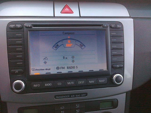

Dears all,
I have problem with compass on Passat 2.0 from 2007y. With MFD2 navi.
Everything works normally until I replaced the battery. Since then, all at zero as seen in Fig. What do I do?
Kind regards and thank you in advance!
