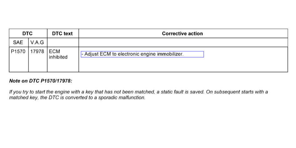

Code reader says P1570 engine no start
2002 VOLKSWAGEN PASSAT
96,000 MILES • 6 CYL • AWD • AUTOMATIC
RWHITES
code reader says P1570 engine no start(immobilizer block) How do you reset ECM to allow engine to start??
Dec 21, 2009 at 6:18 AM
SQM
  • 6,383 POSTS
That code typically gets triggered if a non-programmed key gets used to start the engine.
Try this method to reset:
Turn the key to on position and wait 10 minutes. After 10 minutes the immobilizer light should go off. Then turn off the ignition. This will reset the immobilizer.
