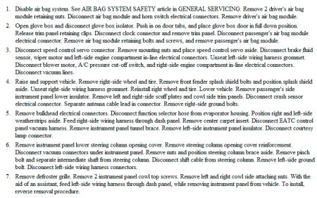

According to Ford you must remove the instrument panel...Sorry! Here is the proceedure!
https://images.2carpros.com/forum/automotive_pictures/62217_BlendDoor2000_copy_1.jpg
https://images.2carpros.com/forum/automotive_pictures/62217_30961_mitchell_2_39.jpg
Good luck, maybe you can get creative, and find another method...
