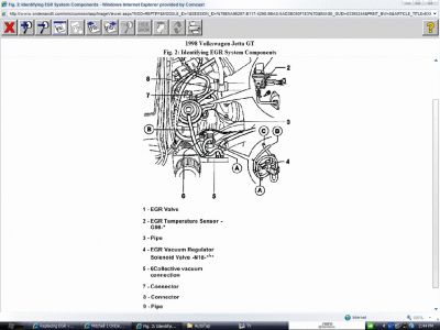

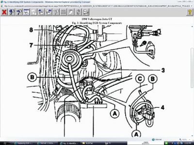

I am replacing EGR (combi-valve) on my 1998 VW Jetta GLX, VR6 - 2.8 engine manual. There is one small air hose on the side of EGR that goes from EGR valve somewhere on the engine. Could someone tell me where does that hose connect to from EGR valve?
Oct 12, 2007 at 5:10 AM
MERLIN2021
  • 17,250 POSTS
Her's a diagram, looks like it plugs into a tee that branches to solinoid and vacuum sourece, you be the judge!
