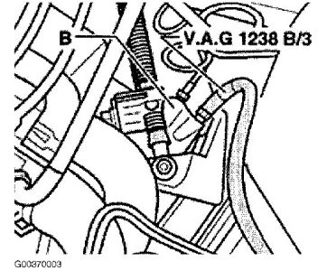

My basic issue is that certain times when trying to shift into any gear really, it is difficult if not impossible to get it into the gear on the first attempt. I have tried to force it into place but it just will not budge. What I have found to work is to simply attempt the shift again by going back up to 3rd, and then down to 4th again. It sometimes takes just 1 or 2 more shift attempts. I am not sure where to start diagnosing this issue, any ideas would surely help!

Have you checked the fluid level of the clutch master cylinder?

Thank you for the quick reply, what is the easiest way to check or refil the fluid levels for the master cylinder?

The Master cylinder is filled by way of the brake master cylinder! ( new to me) IT is bled by a special tool that may not not be necessarily special. The Bleeding is done through the slave cylinder.
https://images.2carpros.com/forum/automotive_pictures/30961_vwshit_1.jpg
My apologies as I am not experienced with this particular system, but only in a general sense. The problem sounds like low fluid. although the master his under the air box, it may not matter regarding filling.
